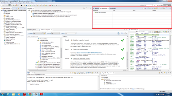

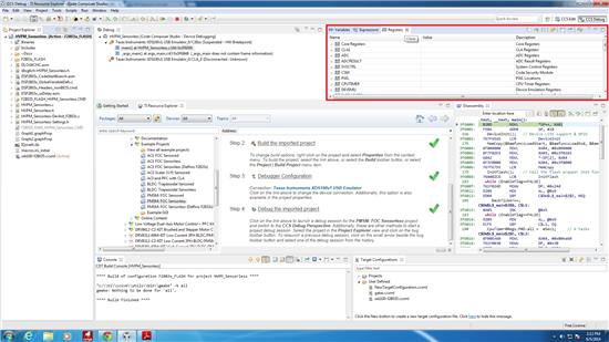

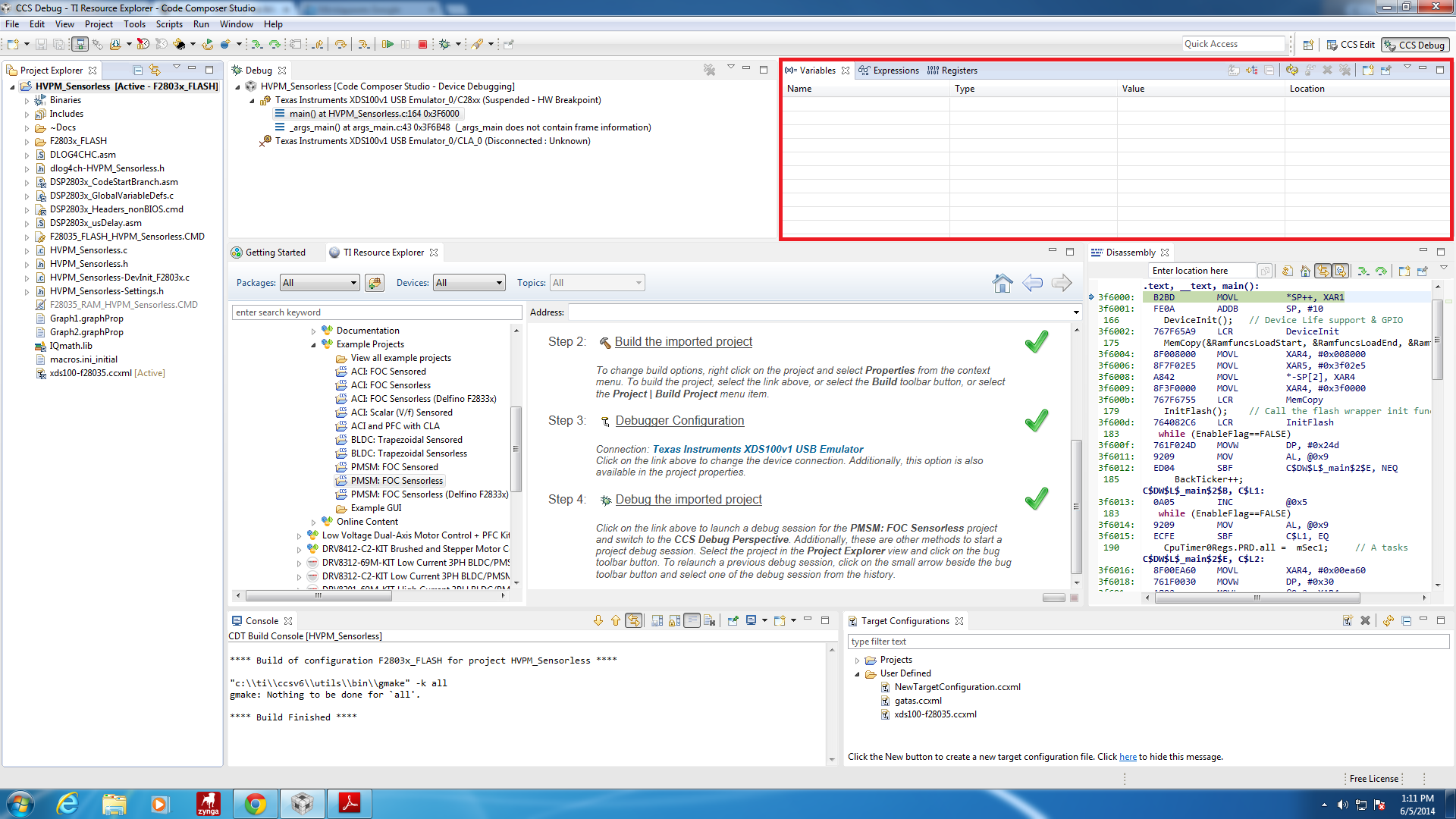

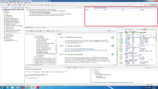

  • Hello again,
    I use BUILDLEVEL 1, as the Doc file says to start with. About the "Expressions" window, there is no variable there nor on the "Variables" one. There are only registers on the "Register" window. I put some pictures bellow:

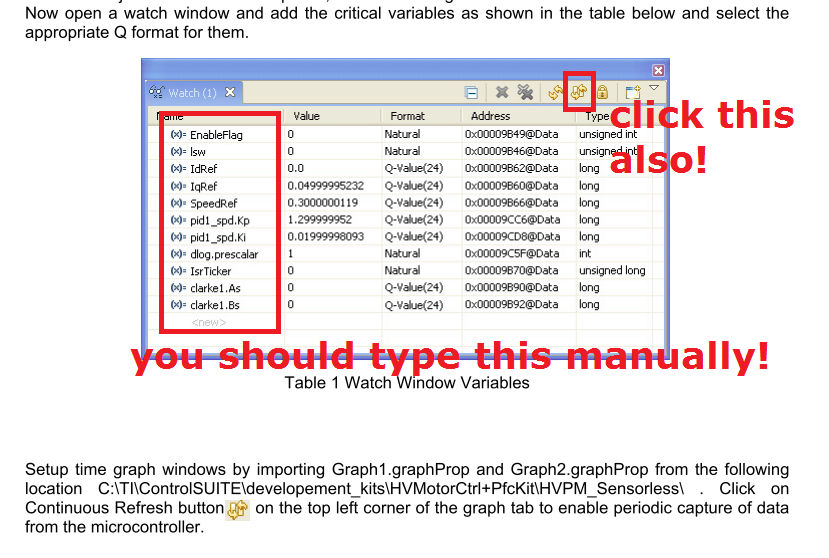

    Here I've posted the Doc file I mentioned above, which I follow the instructions.
    0576.Sensorless FOC of PMSM.pdf
    The Hardware part is correctly installed.
    The Software part starts from page 19 and I'm stucked on "Now open a watch window and add the critical variables as shown in the table below and select the appropriate Q format for them.".
    As you can see in the pictures I ran the F2803x_FLASH, but I assure you that I ran the F2803x_RAM as well and the same screens appeared, as those I've posted above.
    Excuse me for the large post but I try to give you as more details as I can.
    Thanks in advance for any help.
  • TRIANTAFILLOS PIMENIDES said:
    I use BUILDLEVEL 1,
    Then it makes sense that your motor doesn't run because this level is for checking PWM (SVGEN time) and even the documentation says that the motor should not be connected while running this BUILDLEVEL.
    Please read the user guide carefully and do BUILDLEVEL step by step, start from page 21 (Level 1 Incremental Build).
    About the watch window (it should be Expression Window), you should type all variables manually! You also can add other variables that not mentioned in the table if you want to watch them in the debugger.
    Open the graph that provided and see the SVGEN time waveform, compared them with the documentation.
    If you passed this level, then you can continue to next step!
    Maria
  • Hello again,
    I realized that my motor shouldn't start on BUILDLEVEL1 when i read the manual carefully. What I didn't know, nor anyone else could realize, is that by saying "open a watch window and add the critical variables" means "create the variables manually 'cause they don't exist". Well I'll try to do what you said and let you know by tomorrow.
    Thanks for your time and I'll keep you informed if I have any problems.
  • And watch window is actually Expressions window (for global variables).
    Good luck and cheers!
