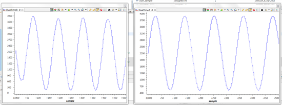

Part of my code is supposed to do following:
ADC is in continuous mode converting two channels at sample rate defined by EPWM2. DMA is using address of ADC mirror ADCRESULTn registers to move data to buffer ADCBufRaw[1080] : first 540 data are from ADCRESULT0, next 540 are from ADCRESULT1. Signal to ADC is sinusoidal burst of few periods - 100 to 20kHz freq range. The problem is that I get stepped sinusoidal form in buffer - few samples have the same value. Times between this hold ups are not constant. Graph of signal I get is shown below.
I tried modifying code for different ADC setup, read reference guides but found no answers. DMA setup is ok - i get correct data. Only DMA memory and buffer are allocated in RAML4 so processor doesn't collide with dma.
Relevant code is bellow:

BUFFERED SIGNAL LOOKS LIKE THIS (AT LOWER FREQUENCY-20kHz)

  • Hi Matija,
    What do you think about using the following debug strategy:
    *First, remove the DMA code and use the CPU to move the samples to the desired buffer.  This should let you fish out any issues with the ADC setup/sampling sequence.
    *Once you are getting good ADC conversion results into your buffer using the CPU, add the DMA code back in to free up CPU bandwidth.  If you know the ADC is working, you can hopefully assume that any issues encountered are due to DMA setup.
  • Thank you Devin for reply.
    I reconfigured acquisition without DMA - I'm using ADC in continous mode and I'm storing data to memory in my main routine periodically. This works without problems at very high ADC speeds and fits to application. For now, I will not use DMA :)
