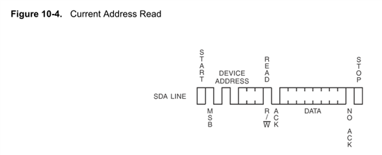

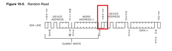

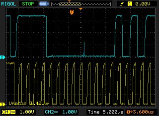

I use 280xx connect eeprom 24c16b (2046byte memory) .but from scoper ,I find eeprom hasn't send ACK bit . it is NACK bit in I2C bus.
my program use consuit I2C-eeprome for 28035. when download to my board. debug. programe can run into i2c_int1a_isr(); but eeprome no respond. I sure eeprome is fine.
this my code and 24c16b datasheet.
where my configuration is wrong?
