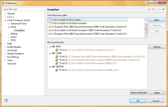

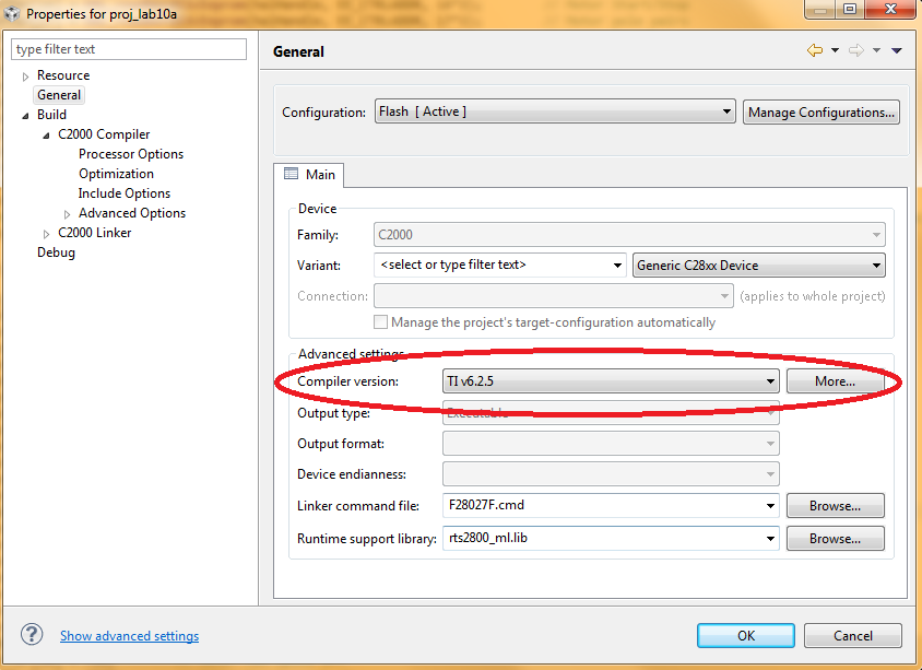

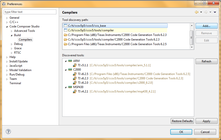

  • Please check the effective compiler being used in CCS. If it is 6.2.0-6.2.2 that's your problem.
    If it's not one of these compilers, attach your user.h in full.
  • Cris,
    NO, I am using old version: CCS: 5.5.0.00077

    I think you misunderstood between compiler and CCS IDE version. They are different.
    Dmitry Rogachev said:
    5.5.0.00077
    This is CCS IDE version! Not the compiler version!
    You can see the compiler version by:
    Right click on your active project --> Properties and then you can see it like below:
    If it is indeed below 6.2.3 version, then you should get the latest one, from here
    http://software-dl.ti.com/codegen/non-esd/downloads/download.htm
    Under C2000 Code Generation Tools Downloads table.
    And install it to your PC.
    To add it, go to CCS, click on Windows --> Preferences and under CCS -> Build -> Compilers click Add button and add the new compiler path that you just install.
    If after this you still have problem on your project, please send again your problem.
    Good luck!
    Maria
