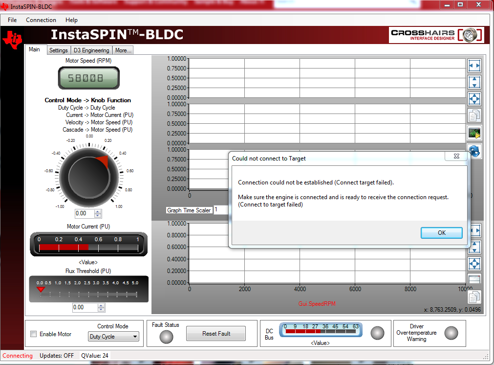

  • I just got this as error
    what do I have to do to make that work? I tried it manually, I still got the same error.
  • Once again, your PC is not able to connect through USB - FTID Chipset - JTAG - MCU.
    There is something wrong with one of the following:
    - power
    - switches on the controlCARD
    - PC installing the driver / connecting (check Device Manager)
    - FTDI chip not being properly programmed from the manufacturer
    - AND beyond the root cause of target failure, to connect the GUI you need to have the proper .out programmed onto the MCU on the controlCARD
  • The strange thing is, first, there is no problem with the power connection. Second, the switches on the control board are setting up the right way: both SW2 are up and SW3 down. Third, there is no problem with driver connecting on the device manager. Now, I don't know for the FTDI chip not being properly programmed from the manufacturer, my question is how do I know that? Fourth, I tried various to program the control board with PM sensorless code I got the error, with InstaSPIN-BLDC I still got the error, and I used GUI Project I still have the error. Another question is, how do I know which proper .out programmed to have onto the MCU on the controlCARD?
    better re-check that user's guide you hate
    Make sure that the following switches are set as described below on the F28035 controlCARD to enable boot from flash and connection to the SCI
    a. SW3: OFF (UP) position
    b. SW2: Position 1 = ON (UP), Position 2 = ON (UP)
    If you want to run InstaSPIN-BLDC_GUI_DRV83xx_v104.exe
    you need to make sure InstaSPIN-BLDC_GUI_DRV8301_v104.out is programmed onto the mcu (if you have the DRV8301, there is a different .out for DRV8302).
    If you need to check your FTDI chip or re-program see this post
    http://e2e.ti.com/support/microcontrollers/c2000/f/171/t/21086.aspx
  • With SW3 on the OFF position(up), I still got the same error.
