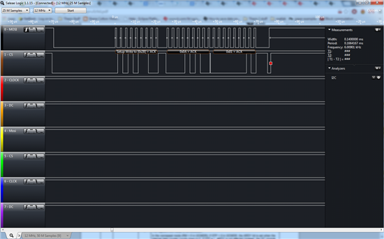

Hi all,
I have custom instaspin controllers on a PX4 quad using I2C... Everything works for a single byte set-point protocol but I want to use 2 bytes for better resolution. When I simply read two bytes successively I get the same byte read twice - I need something to wait in between the bytes but I cannot figure it out-OR something to tell the master to wait??? I found a few resources which basically say while !stop bit keep reading data in - but in the case below I will usually see 0x1 or 0xA for both the high and low byte- they toggle around and seem to get confused... -I'm using the wrappers Michael Jordan posted here: http://e2e.ti.com/support/microcontrollers/c2000/f/171/t/238353.aspx
Basically, what are the steps that are required to read two bytes of data over I2C?

    Re the I2C-
    No I am not using FIFO and at the time of my first post I was just polling the I2C outside of the InstaSPIN mainISR - wasn't interrupt driven...
    Now I have it interrupt driven (motorware guys really dropped the ball with I2C - had to add all the PIE stuff for I2C - why I took a while to respond) which is running really nicely for reading in a single byte at a time...
    This will have to suffice for the time being as I want a video for a presentation next week (-FOC esc was my undergrad project)... i.e no technical questions at the moment, but I am going to keep trying with the two bytes read in next week so i'll leave the thread un-answered and might resuscitate it next week.

  • Thanks Trey...
    Quad just had its first successful flight with my FOC controllers on I2C!!! Still only using a single byte I2C driver... Would post a vid but the size restrictions are too tight/
    Not sure if you've played with a 3DR PixHawk at all, but on the off chance you have, i'm running the I2C driver by microkoper - mkblctrl pretty much raw...
    I2C headers are attached - can't remember if I changed anything from Michael Jordans, been playing with it on/off for a few months now.
    Setup in my main.c (itself a hybrid lab 5a/b instaspin mix)...

    This is a slimmed down I2C routine - mine has some set-point management stuff in it as-well, but this is the crux of it...
    As mentioned, this setup is flawless when I use it for a single byte read in. It doesn't work with a two byte protocol (logic pic from OP) - in that case I just read in the data (ReqID) twice... as in ReqID[0] = I2C_getData(i2cHandle); then immediately ReqID[1] = I2C_getData(i2cHandle); ... I have also tried reading in RegID[] on each interrupt and keeping an index to track... after first read, stay in interrupt until SCD bit/ bus busy bit/ and every other combination I could think of...
    *This is my first play with I2C (conceptually more difficult than SCI/SPI IMO) so it is entirely possible I am missing something fundamental for a multi-byte read in protocol... Not sure, most examples/explanations are for the master side which as I understand it should handle all the nuts and bolts of it and I (slave) should just wait for data and read/send accordingly?
    Thanks, hope that made some sense - hard to explain where I'm at with this.
