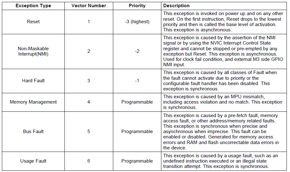

Is it possible to disable the "Hard Fault" of Concerto?
Please tell me if there is a register that can be the "Hard Fault" Disable setting.
Hard Fault can not be disable. It's part of ARM core logic. This is done to make sure if there are some serious error and user has not enabled then then at least Hard Fault will get triggered.
