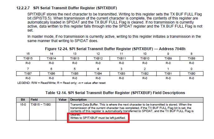

I am working on 8bit SPI cycle on 28069.
I create a 4 cycle 0x00 0x00 0x00 0x01 4 8bit cycle on SPI master to drive MOSI to one at the last cycle LSB.
I saw the SPITXBUF set to 0x01 on the last  8bit cycle.. However, I didn't see a bit set to one on MOSI.
Please advise.

    Are you using 8bit or 16bit cycle?
    Your SPICCR set to 16bit  0x009F. Should it be 0x0097 instead?
    SpiaRegs.SPICCR.all =0x009F; //
    Ken
  • Ooops, good catch.  I changed the initial initialization, but not the line where it brings it out of reset.  Just tested and now I see what you're seeing.  Let me investigate further.
    BR,
  • If you look at the user guide for this peripheral you'll find that writes to this register need to be left justified.
    BR,
  • Could you give an example ?
  • Trey,
    I think that I got it.
    Thanks.
    Ken
