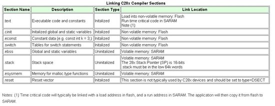

From the TI wiki page it states that initialized global and static variables are in .cinit section and located in Flash. As a result I couldn't understand how all the variables and arrays are located RAM.
I have referred the SPRA958L for running my code from Flash. I haven't added the DSP2833x_Headers_nonBIOS.cmd as the address for RAM and Flash were overlapping the one I have in F28335.cmd file.

  • Hi Gautam,
    I have initialized the variables and arrays to zero, according to the TI wiki page they will be in .cint section, and placed in Flash, right?
    Only "Executable code and constants" (in the note its mentions only for "Critical code") which are located in .text will be moved from Flash to RAM . Does it also include all the variables Global, arrays, initialized and uninitialized?

  • Pankaj,
    if you create global arrays then those get counted into the DATA section which goes into RAM, the .cinit section contains the initialization values that go into the initialized global data.
    If you want to create the array only when you need it in a function, try using local arrays (arrays declared inside a scope of function, these go into stack), you could also create a single global array and initialize it with data from flash in your function before using it and move the data back to flash after you are done with it, so some other function can use this.
    compiler or tools won't automatically do this for you, you will have to do something like above in your application as it fits your needs.

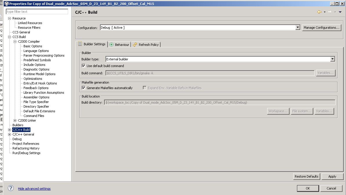

    can you check if you have floating point options turned ON in the project compiler options? I'm not sure these two problems are related. Try using float in a simple blinky example and see the difference.
    Best Regards
    Santosh
  • Dear Santosh,
    Can you tell me where exactly is the floating point option are as I didn't find the setting. When I run the code from FLASH  with few arrays, it works fine. So the setting should be fine. In short

  • Pankaj,
    if you have floating point options turned ON (in compiler options, right click on the project shows a window where you can browse for these options) then make sure what you are passing on to the Float instruction ( the memory this instruction is acting on) obviously something must be wrong with it that is causing the error. Also by ILLEGAL_ISR do you know which interrupt is occurring (ITRAP or some other PIE interrupt).
    Best Regards
    santosh

  • Hi Pankaj,
    I guess, Santosh is talking about this window:
    Gautam
  • Dear Gautam,
    Thanks for the screen shot. My current setting is the same as mentioned fpu32.
    I am using few float64 to store the multiplication of float32, so I changed it to fpu64. I got a Load Program error. The .out file could not be opened. I tried changing the work space but I still get the same error.
    I don't know about much about GEL file that needs to be added.
    Pankaj Kadam

    I copied my code into the example flash program and added all necessary files. I enabled the optimization to level 1 and the code was able to run past the function that contained the float32 calculation and other parts of the code.
    After enabling the optimization, I observed an odd behavior during step wise execution, the control  jumps and repeat previous instruction and then come back to current instruction, this continues throughout the program. I ignored it initially, but after applying the input, the ADC is not capturing any values. Have you come across any similar issue?
    I tried applying the on-board 3.3V, still the value captured was zero.
