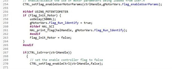

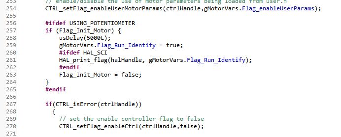

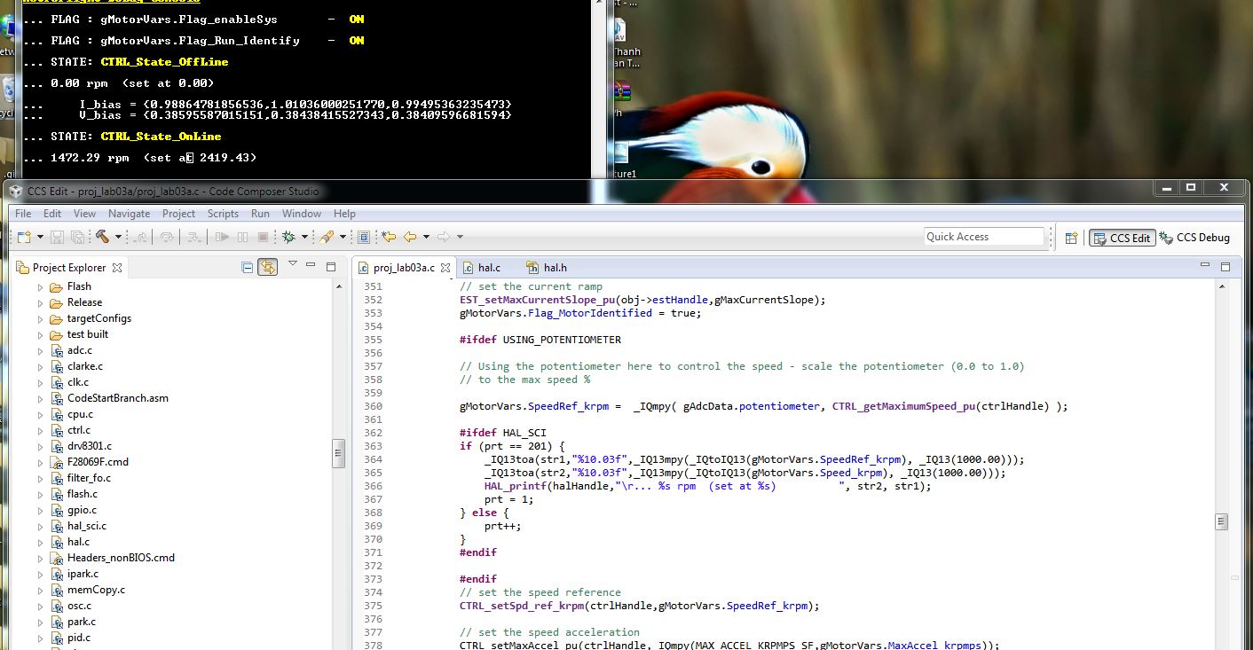

    - I think we would want to have the SCI included too. For example, this is what I have:
    then we could see the potentiometer working with some shown data
    (I had this code in flash and running it without toggle the flags )
    And of course if we have a multitasking examples added ( for debugging/control) then it would be a big bonus.

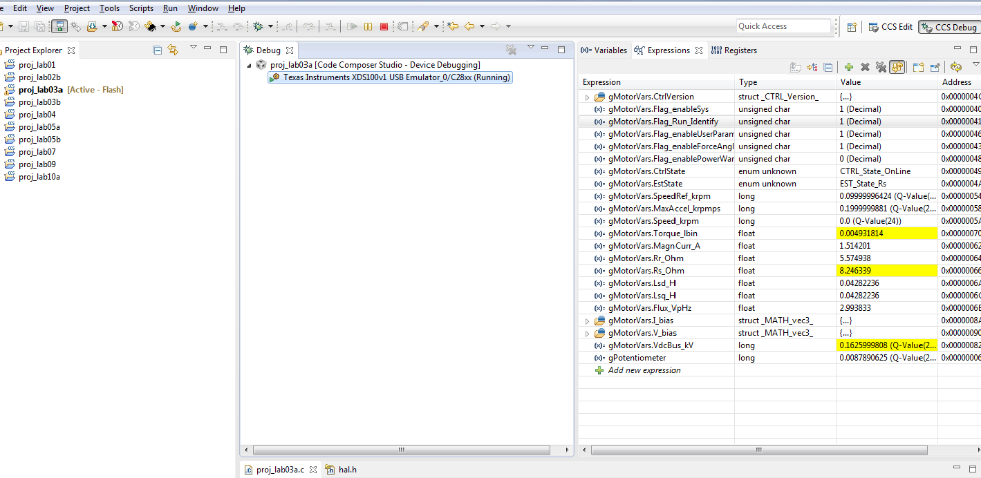

    A usefull document for someone that don't understand nothing (like me) and try something on InstaSPIN FOC. The document have a simple language and clarified some basic things. I'm trying implement the potenciometer read. I want use the Launchpad w/28027F for a high voltage ACIM control, so I exported the motorware projects (C:\ti\motorware\motorware_1_01_00_12\sw\solutions\instaspin_foc\boards\hvkit_rev1p1\f28x\f2802xF\projects\ccs5) and try understand the code to adapt to my own purpose. After follow all the instructions on the tutorial, I have a doubt about the last part:
    "And we call the new function we created in a background loop, outside of the interrupt to avoid any CPU bandwidth hit.
    gPotentiometer = HAL_readPotentiometerData(halHandle);" (page 22)
    I already try all, but the value showned on gPotenciometer its always the same and no matter the position of the potenciometer. So, I don't know if I'm put the code at the right place or if it's missing something... Sorry for this basic question.

  • Can you try putting that function call in the ISR? If you put it in the background loop of a MotorWare project, keep in mind that the forever loop is stuck checking the enable system flag, so enable the system before checking if the potentiometer value read changed.
    // Waiting for enable system flag to be set
    while(!(gMotorVars.Flag_enableSys));
    -Jorge

  • Hello Jorge,
    Thanks for your reply. I already try everywhere and the result it's always the same.
    This is the value that I get, no matter the position of the pot.
    0447.proj_lab03a.rar
    using a standard user.h, because I don't have any motor connected yet. I'm trying understand the code before start with the experiments with the motor, so I don't know if this will create any problem for the experiment with the pot.
    Bruno Ramos

  • The example in the document is done for a 6x device. Seems like you are using a 2x device. This POT is connected to signal B0, but that B0 is connected to B7 through a switch:
    This switch is actually required to have pins 4 and 5 connected so that ADC-B7 (connected to motor phase 1 voltage) is connected to the ADC pin B7 of the 2xF. That actaully leaves ADC-B0 (POT connected here) disconnected.
    The quickest way to confirm this POT reading example is if you use a 6xM control card:
    http://www.ti.com/tool/tmdscncd28069miso
    Do you have one of these?

  • Bruno Ramos1 said:
    Unfortunatelly I don't have any 6xM control card to confirm the value of POT. But what really change in the software configuration between the code on the tutorial for 6xM device to 2xF device?
    Nothing changes from 6x to 2x as far as ADC configuration as it is the same ADC. What changes is what channel you want to add in the example. We added B0, since in the 6x there is a POT connected to this channel. Please reasign the following to any channel where you have some analog signal that you would like to try out using the 2x:
    // Potentiometer
    // Configure it so that ADCINT1 will trigger a potentiometer conversion
    ADC_setSocChanNumber(obj->adcHandle,ADC_SocNumber_8,ADC_SocChanNumber_B0);
    ADC_setupSocTrigSrc(obj->adcHandle, ADC_SocNumber_8, ADC_Int1TriggersSOC);
    ADC_setSocSampleDelay(obj->adcHandle,ADC_SocNumber_8,ADC_SocSampleDelay_9_cycles);
    The highlighted text is the input channel assign to ADC result 8. Everything else in the example applies, so simply change the channel.
