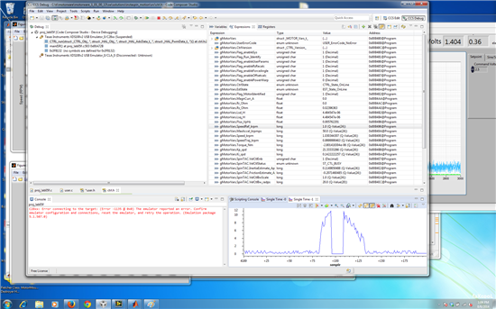

    I'm still not understanding why my Is_A current is set to zero when it becomes too high. Is this a saturation problem? My current sense resistor divider is scaled for +/-40 amps (see graph below).
    Also, I still can't explain why I'm able to run the dev kit PWM frequency anywhere from 30-90 kHz, but our custom motor controller only runs when at 90 kHz. I already replaced all of the dev kit current sense and voltage sense resistors to be equivalent in scale to my board, and I'm running essential the same code (except for difference in GPIO pin numbers).
    Any thoughts on these two issues?
  • We found a solution to the problem. Thank you for all your help along the way. It turned out that we need to reduce the sample delay from ADC_SocSampleDelay_9_cycles to only ADC_SocSampleDelay_7_cycles, and this fixed all our problems. We're now able to run at a lower PWM frequency, and the noise in the Vc (voltage sense for phase C) has been dramatically reduced. Please pass this information along to other developers, as I wouldn't have believed that changing the sample delay by 2 samples would have such a significant impact on performance.
