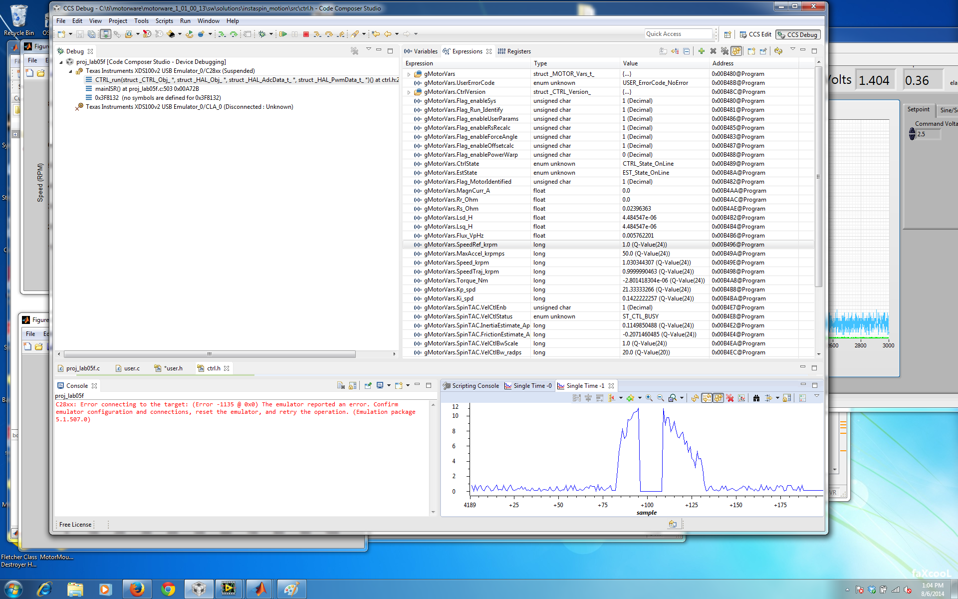

  • Hi Chris,
    Thanks for all of your support in the past. We have our custom motor controller board completed and are in the process of identifying and tuning the motor control. I'm following up on this thread because it is the same motor and schematic which you reviewed in the past.
    We're having difficulty spinning at high rpm (>10krpm) and have a few follow up questions for you. There is a little more noise than I expected in the measured current signals. Do you have any example scope shots of the measured motor phase voltages and currents that I can use as a reference?
    We're able to use the lab_02c to identify the motor parameters, but once identification is complete and we re-enable the motor and command a particular speed, it is unstable. How are the gains changed from the identification phase to the on-line phase?
    We would very much like to tune the FAST current loop in real-time on a scope, as described in lab_05a. Where is the reference trajectory set in the project code? I'd like to be able to drive the reference current and tune for different step and sine waveforms. Will I be able to measure the reference signal as an output on my scope? Also which current signal should I measure for tuning purposes? i.e. phases A, B, or C?
    Does the DRV-8301-69M dev kit use an internal or external oscillator? And do you see a performance difference at high speeds?
    Thanks again for your support!
    Remind me about your motor, attach the user.h.
    Your HW is based on BOOSTXL-DRV8301?
    There are scope shots in SPRUHJ1, but not of high speed. I posted some high speed (4 KHz) scope shots using DRV8312 recently:
    http://e2e.ti.com/support/microcontrollers/c2000/f/902/p/339361/1242590.aspx#1242590

  • Hi Chris,
    Thanks for the feedback.
    Hardware is based on the BOOSTXL-DRV8301.
    I've attached our user.h file for you to review.
    Our scope shots definitely look nothing like your clean sine signal. You can see the PWM switching in our signal. Should we add a cap on the output to smooth the current sense signals? Also I noticed in the other forum that you recommended adding an external inductor. Would you recommend the same for our case considering that we're using a 5.5uH inductance motor? It would be difficult to add this in-circuit at this point, but would it be possible to add them in series with the motor phases?
    I'll try project lab05a to set the current/torque reference signals.

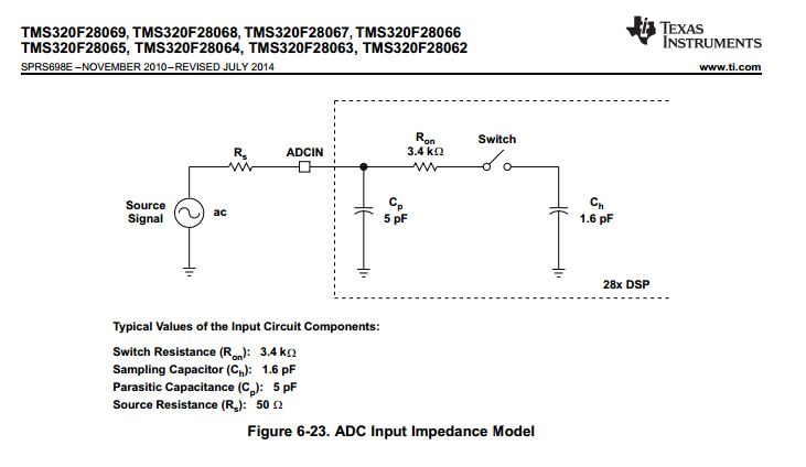

    Also I noticed in the other forum that you recommended adding an external inductor. Would you recommend the same for our case considering that we're using a 5.5uH inductance motor?"
    Your user.h says you have a 20A motor, but you have a short circuit current of 159A. That's "over designed" by about 4x.
    So you could increase your Ls by 4x and still get the same torque capability with InstaSPIN-FOC.  However, going from 6uH to 24uH won't buy you that much...it would be better if you could get to 50uH+, but then you will reduce some torque performance.
    With motors that have THIS little flux and THIS little inductance I would say that a flux based observer and lower shunt sampled current control approach probably isn't the most worthwhile.
    No, that causes probablems with the estimation since the Vph samples are no longer real.

    1. How do you adjust the graph settings so that it automatically scrolls with new data (I've already set it to auto refresh)?
    2. I can view the commanded or reference current IqRef_A, but how can I output my actual current, both in the list of expressions and in a graph? I tried adding Iq_A but this isn't being updated in the code.
    3. Do you have any other suggestions for good torque performance at low speeds using the spinTAC controller? How does the FOC controller compare at low speeds?
    4. Do you have any examples of achieving RPM higher than allowed from back-EMF using field weakening?
    Thank you again for all of your help.
    Chris
  • One more thing to add, I was able to output both IqRef_A and Iq_A as expression in project lab_05f, but at least looking at the expressions list, my current tracking performance looks very poor. I'm assuming that these two numbers should be right on top of each other. I'm very interested in seeing a graphical display in real-time of these values.
    Chris

    I'd like to be able to tune my current and bandwidth gains while looking at a real-time plot. I've tried loading the graph file described in lab_05f, but the graph doesn't scroll when updated so I'm never looking at the most recently acquired data.
    do you have the refresh enabled?
    we start pulling this in labs 9 and 10. You can add it to your own project:
    are you pulling values inside an interrupt? in our labs we are pulling the values in the background task, so there isn't anything that guarantees they are synchronized.
    your expression list also isn't "keeping up" with real-time data, at least not at the control frequency rate.
    to really check this you would need to actually "get" inside the interrupt and datalog all the data and then compare it off-line.

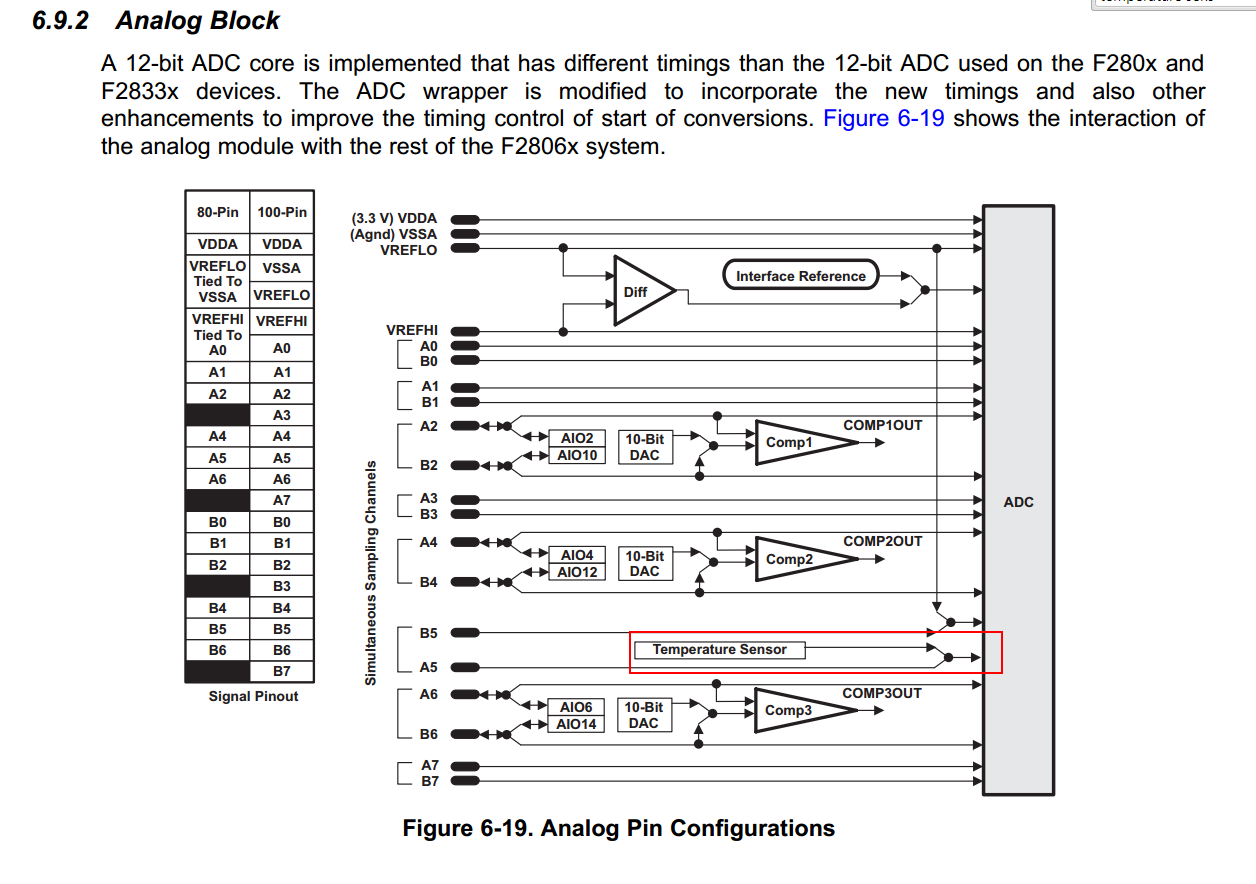

    One question that came up this morning is how do I configure my faults in hal.c for a custom board. It appears that you're using trip zones 2, 3, and 6 on the dev board, but these are not configured for my MCU. My OCTW and FAULT pins are connected to GPIO inputs as follows:
    // OCTWn
    GPIO_setMode(obj->gpioHandle,GPIO_Number_7,GPIO_7_Mode_GeneralPurpose); // GPIO_13_Mode_TZ2_NOT **
    // FAULTn
    GPIO_setMode(obj->gpioHandle,GPIO_Number_8,GPIO_8_Mode_GeneralPurpose); // GPIO_14_Mode_TZ3_NOT **

    I don't see where TZ6_NOT is tied to any pins in the drv8301 dev kit example. Is this defined elsewhere in the program? Is there a default input?
    PWM_enableTripZoneSrc(obj->pwmHandle[cnt],PWM_TripZoneSrc_CycleByCycle_TZ6_NOT);
  • from SPRUH18
    section 3.2.7
    TZ1 to TZ3 are sourced from the GPIO mux. TZ4 is sourced from an inverted EQEP1ERR signal on those devices with an EQEP1 module. TZ5 is connected to the system clock fail logic, and TZ6 is sourced from the EMUSTOP output from the CPU.

  • One other issue that we're seeing is that the estimated current from the example projects, for instance 5f, shows a much lower current than that measured across a shunt resistor with a scope. Applying a steady load to the motor, we're observing 4 - 5 amps in software (from Is_A), but are only measuring rougly 12% of that on our shunt resistor connected in series to our power supply, roughly 0.5 amps. Would you expect this large of a discrepancy in the estimated value? Besides the USER_IQ_FULL_SCALE_CURRENT_A and USER_ADC_FULL_SCALE_CURRENT_A, how is this value scaled?
    Another thing to note, is that when applying an increasing load to our motor, we observe that the estimated current drops to 0 (see attached image). It almost seems that its an overflow or saturation problem with this value. Any thoughts?
    Chris
  • On the ADC topic this is pretty strange.  I thought it was that the INT wasn't enabled correctly, but it should be done in the following function:
    HAL_enableAdcInts
    ADC_enableInt(obj->adcHandle, ADC_IntNumber_1);
    all of your SocNumber_1 - 7 are all being executed and motor functions correct?  You just aren't getting any of your other values?
    have you updated
    HAL_readAdcData
    to actually read these values?
    Regarding current going to 0 under load, this is the Is_A value?  Is your Iq_A going to 0 at the same time?
  • Yes all SocNumbers1-7 are being executed correctly and the motor functions properly (although weren't limited in torque). The ADCs are not being updated while running the program. Could it be that there isn't sufficient time to trigger this interrupt?
    The Iq_A is roughly 15-20amps and the Id_A is very small, less than 1 amp, but neither are zero.

  • Going a little deeper, I notice that there is an oscillator temperature compensation function which is pulling from analog input A5 for the dev kit. Is this being called anywhere in the project? We have a different signal connected to analog input A5.
    Chris

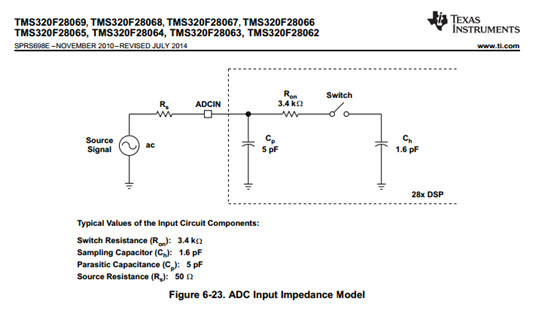

  • S+H duration is chosen based on external hardware.  The signal source driving the ADC input should be able to charge Ch to within the desired accuracy (typically better than 1/2 LSB) of its final value during the S+H window. With 50 ohm Rs, minimum S+H of 7 cycles can certainly be used, but a higher source impedance may require a longer S+H duration.
    The temperature sensor is available as an internal connection on channel A5.  When enabled, it ignores what is externally on A5:
    As far as the triggering, using ADCINT1 isn't really much different from using the ePWM from a timing perspective (below is assuming you use all the extra SOCs):
    ePWM1A triggering SOC0 to SOC15
    ePWM1A triggering SOC0 to SOC7, SOC7 triggers ADCINT1, which triggers SOC8 through SOC15
    If you want to decouple the additional signals (SOC8 through SOC15) from ePWM1A, then it is probably better to use a spare ePWM, CPU timer, or software trigger.
  • Hi Devin,
    Thanks for the feedback. Then in the case where I have a resistor divider on my voltage sense lines of 14.3K and 4.99K, then I should have a much higher S+H duration? My current sense lines are directly connected from my DRV8303 to my MCU, but the DRV chip probably has a very high input impedance. What would you recommend for a S+H in these two cases?
    I'll stick with using ePWM1A if you don't think this will make a difference in performance.
