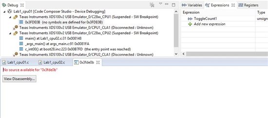

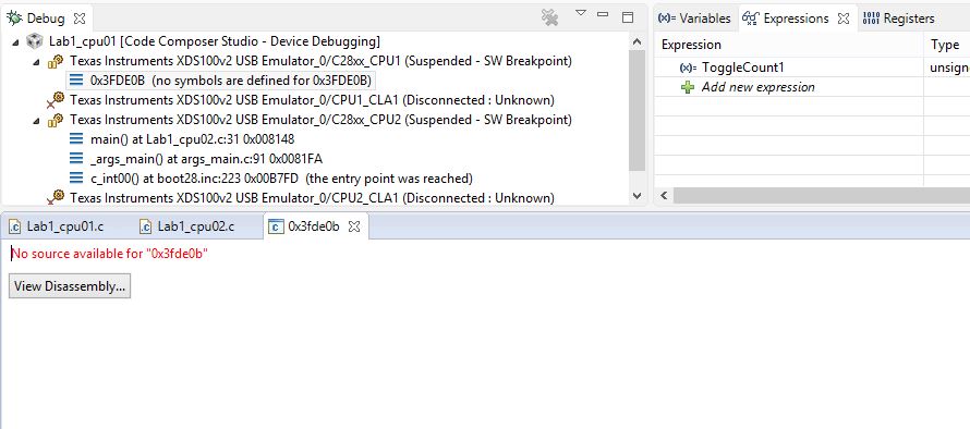

No source available for "0x3fde0b" F28377D
Other Parts Discussed in Thread: CONTROLSUITE
Hello everybody. I have a F28377D control card and I'm trying to do the F2937xD Workshop programs, but when I push the play button, the program doesn't run, and returns me this window:
I followed all the steps in the manual "Workshop guide and Lab Manual (http://software-dl.ti.com/trainingTTO/trainingTTO_public_sw/F2837xD/F2837xD_Workshop_1-0.pdf), ¿anybody knows why?, I want to program the RAM memory.

  • Hi Gautam,
    I press the button one or more times with the same result. I keep trying now, and I've noticed that if I stop the program using breakpoints in CPU01, the program works, if I remove the breakpoints stops working again ... Or if I start CPU02 too ... Can be a problem with GEL file?
    Thanks!
