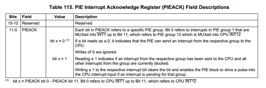

    There's no issue here! If you go through the document SPRUFB0D :
    In short, its not individual interrupts you can acknowledge but the whole group.
    Generally for eg. we use: PieCtrlRegs.PIEACK.all = PIEACK_GROUP1;
    Gautam

  • Hi Josue,
    If you read the description for this PIEACK register that Gautam posted, note that the register will read-back a '1' in a bit position if that interrupt group is pending.  When you use the .bit sub-field in your C code, the compiler can not generate an instruction to directly write to that bit/group of bits, so it instead generates a read-modify-write sequence of instructions on the whole PIEACK register.
    Because of this, when you try to write '1' to .bit.ACK1 only, it reads the whole PIEACK register, modifies the read value to set the bit in the ACK1 field, but also finds 1 in the ACK2 field, and writes back the 1 that it found in an attempt to preserve the contents of the register (but really this clears that field).
    I think you will want to use the
    format when acknowledging the interrupts (it is fine to use the .bit fields to read the status).
