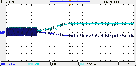

Current peak at Identification
I have a strange error during ID of a PMSM at my own hardware. On the oscilloscope I captured the attached file.
At RampUp befor STATE_RS i get a current peak. When I try the ID with a  dcbus higher than 100V the current peak is even higher. My self written fault detection stops the system when a current > 10A is measured. This is strange because it was working fine the last time. Have you seen something like this before? Can you give me a hint? I’m using Motorware12 and CCS6 with Compiler 6.3...
Tanks for your support
Regards Matthias

  • when does this happen exactly?
    RoverL is the first state, then Rs, then RampUp.  It looks like the transition to Rs where the user.h RES_EST_CURRENT is used.
    Makes me think that your ADC and IQ voltage/current values in user.h are not matching your hardware values.  Please triple check those calculations for your board referencing SPRUHJ1 chapter 5.
    Michael, current probes will allow you to clamp around a phase wire.  Highly recommend for motor control applications.  In a pinch you can plot the ADC results using CCS.
