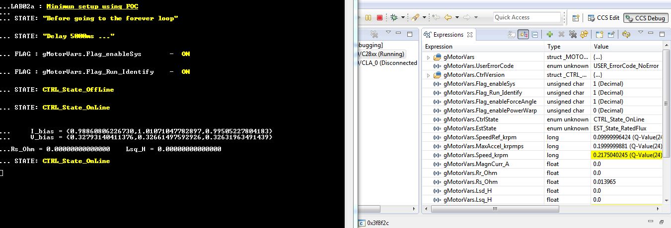

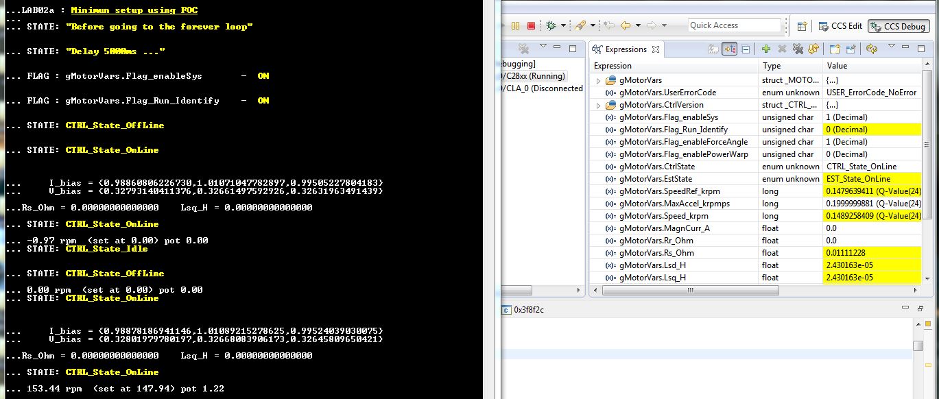

A question on lab02a
In this lab I can see that the Motor ID process spins the motor to find out the I_bias and then the V_bias.
With my setup, at this time the motor spins at 218rpm instead of 100 rpm as the SpeedRef_krpm said (see picture above).
Later on, when it changes state; the Speed_krpm follows the SpeedRef_krpm in the following picture.
How does  the motor ID process work?
The value returned by CTRL_getMaximumSpeed_pu(ctrlHandle) is .12.
What dictates the maximum speed pu ?
    No, the bias is found initially before any of the ID process begins.  The motor doesn't spin until RampUp phase.
    The speed target for RampUp is set by #define USER_MOTOR_FLUX_EST_FREQ_Hz and PU is set by any value / #define USER_IQ_FULL_SCALE_FREQ_Hz
    Please read SPRUHJ1 - it is very detailed on the ID process.
