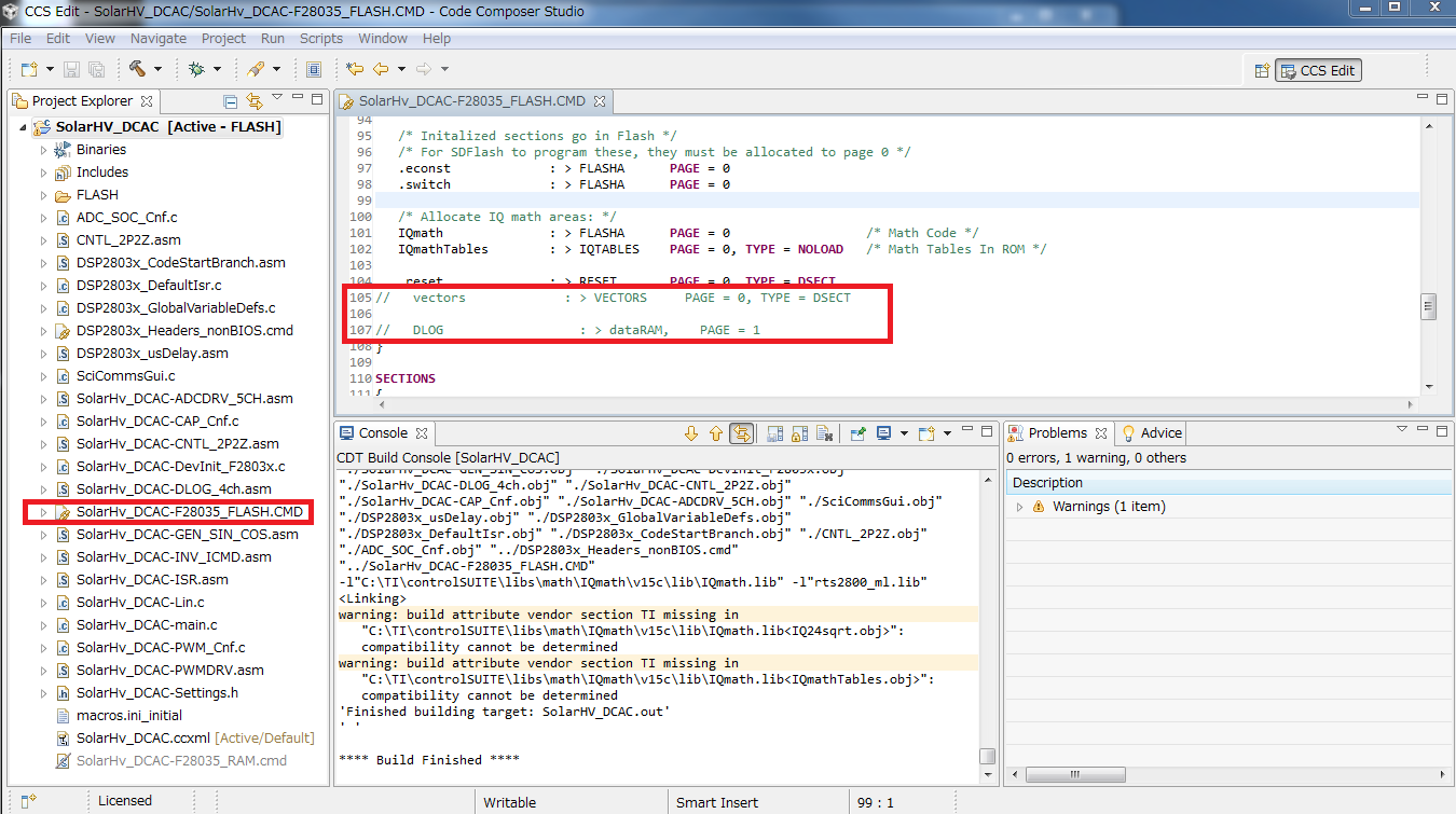

Although it is a project of SolarHV_DCAC that are provided with Controlsuite,
Build error will occur.
By commenting out the following SolarHV_DCAC-F28035_FLASH.CMD file
Build error Can this be fixed, but I will no problem?
・Before change
vectors             : > VECTORS     PAGE = 0, TYPE = DSECT
DLOG              : > dataRAM,    PAGE = 1
・After change
//   vectors             : > VECTORS     PAGE = 0, TYPE = DSECT
//   DLOG              : > dataRAM,    PAGE = 1
I am using the following environment.
CCS : 5.4.0.00091
Compiler : TI v6.1.3
ControlSuite : v3.2.7
Thank you for confirmation.
Best Regards.
hamada
  • Hi Hamada,
    Why is that you're commenting the above lines?
    Gautam
  • Hi, Gautam
    Thank you for Reply.
    If you don't hava a commnet out, build didn't pass.
    I attach the log of execution if you do not want to comment out.

    'Building target: SolarHV_DCAC.out'
    'Invoking: C2000 Linker'
    "C:/ti/ccsv5/tools/compiler/c2000_6.1.3/bin/cl2000" --silicon_version=28 -g --define=FLASH --diag_warning=225 --large_memory_model --unified_memory --cla_support=cla0 --c_src_interlist -z -m"SolarHV_DCAC.map" --stack_size=0x300 --warn_sections -i"C:/ti/ccsv5/tools/compiler/c2000_6.1.3/lib" -i"C:/ti/ccsv5/tools/compiler/c2000_6.1.3/include" --reread_libs --xml_link_info="SolarHV_DCAC_linkInfo.xml" --rom_model -o "SolarHV_DCAC.out"  "./SolarHv_DCAC-main.obj" "./SolarHv_DCAC-PWM_Cnf.obj" "./SolarHv_DCAC-PWMDRV.obj" "./SolarHv_DCAC-Lin.obj" "./SolarHv_DCAC-ISR.obj" "./SolarHv_DCAC-INV_ICMD.obj" "./SolarHv_DCAC-GEN_SIN_COS.obj" "./SolarHv_DCAC-DevInit_F2803x.obj" "./SolarHv_DCAC-DLOG_4ch.obj" "./SolarHv_DCAC-CNTL_2P2Z.obj" "./SolarHv_DCAC-CAP_Cnf.obj" "./SolarHv_DCAC-ADCDRV_5CH.obj" "./SciCommsGui.obj" "./DSP2803x_usDelay.obj" "./DSP2803x_GlobalVariableDefs.obj" "./DSP2803x_DefaultIsr.obj" "./DSP2803x_CodeStartBranch.obj" "./CNTL_2P2Z.obj" "./ADC_SOC_Cnf.obj" -l"rts2800_ml.lib" -l"C:\TI\controlSUITE\libs\math\IQmath\v15c\lib\IQmath.lib" "../DSP2803x_Headers_nonBIOS.cmd" "../SolarHv_DCAC-F28035_FLASH.CMD"
    <Linking>
    "../SolarHv_DCAC-F28035_FLASH.CMD", line 107: error: conflicting placement
    >> Compilation failure
       methods specified for "vectors"
    "../SolarHv_DCAC-F28035_FLASH.CMD", line 107: error: expecting output section,
       GROUP, or UNION instead of ":"
       GROUP, or UNION instead of ","
       GROUP, or UNION instead of "="
    warning: build attribute vendor section TI missing in
       "C:\TI\controlSUITE\libs\math\IQmath\v15c\lib\IQmath.lib<IQ24sqrt.obj>":
       compatibility cannot be determined
       "C:\TI\controlSUITE\libs\math\IQmath\v15c\lib\IQmath.lib<IQmathTables.obj>":
    "../SolarHv_DCAC-F28035_FLASH.CMD", line 107: warning: memory range not found:
       DLOG on page 0
    "../SolarHv_DCAC-F28035_FLASH.CMD", line 105: error: program will not fit into
       available memory.  run placement with alignment/blocking fails for section
       "vectors" size 0x0 page 0
    error: errors encountered during linking; "SolarHV_DCAC.out" not built
    gmake: *** [SolarHV_DCAC.out] Error 1
    gmake: Target `all' not remade because of errors.
    **** Build Finished ****

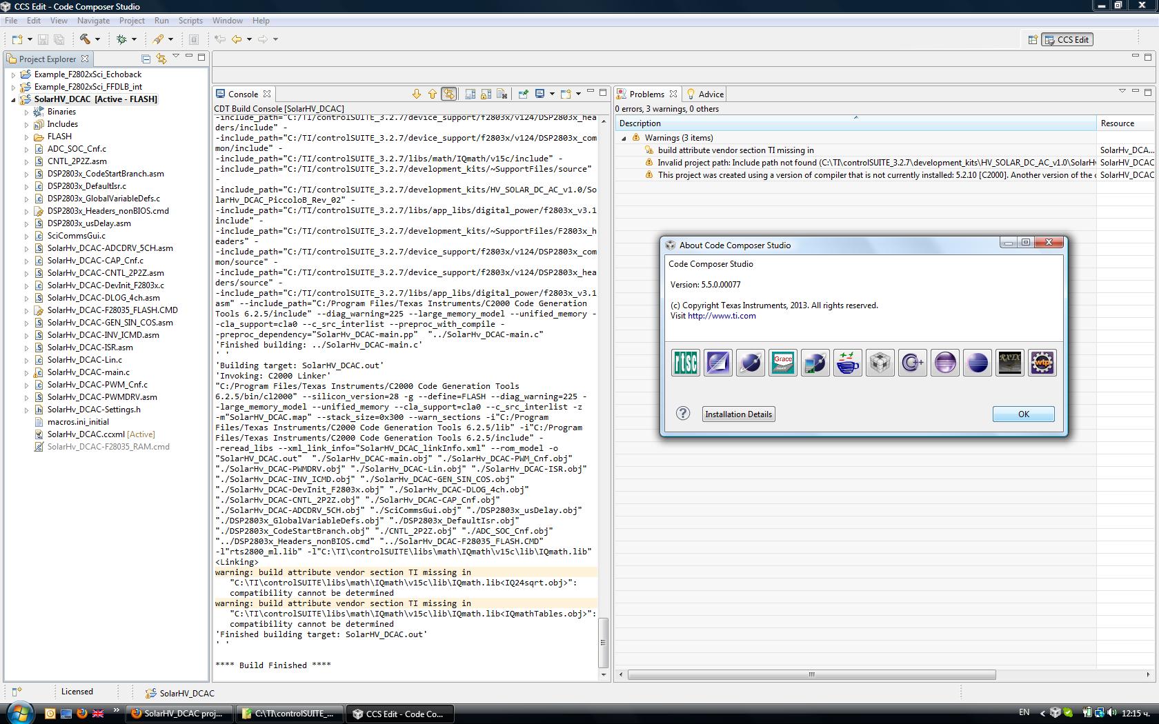

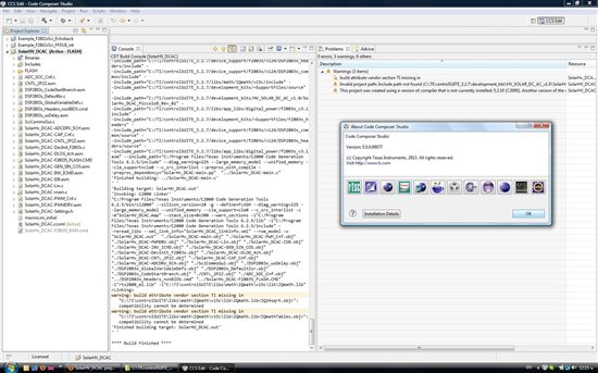

  • Hi, Gautam,
    CCS :  Version: 5.5.0.00077
    Compiler : TI v6.2.0
    I was confirmed in the above environment.
    The same build error came out.
    hamada

  • That's indeed strange!
    I loaded the same project C:\TI\controlSUITE\development_kits\HV_SOLAR_DC_AC_v1.1\SolarHv_DCAC_PiccoloB_Rev_02 and built it directly and there was no such error.
    I am using CCS 5.5 and controlSuite v3.2.7.
    Have you tried to "Rebuild" instead of "Build" ?
    Did you copy the project or link it when you load to CCS?
