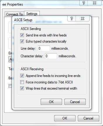

HI all
I compiled and programmed sci echoback code to f28021 controller. when I was testing it, I am able to transmit the data from controller to pc but not vice versa. could any one suggest me what could be the mistake or where could I get the sample code link other than control suite( I use now that).
  • Hi PN,
    I hope you're enabling these features in Hyper terminal.
    Gautam

  • scia_fifo_init(){
    SCI_enableFifoEnh(mySci);
    SCI_resetTxFifo(mySci);
    SCI_clearTxFifoInt(mySci);
    SCI_resetChannels(mySci);
    SCI_setTxFifoIntLevel(mySci, SCI_FifoLevel_Empty);
    SCI_enableTxFifoInt(mySci);
    SCI_resetRxFifo(mySci);
    SCI_clearRxFifoInt(mySci);
    SCI_setRxFifoIntLevel(mySci, SCI_FifoLevel_1_Word); //4_Words
    SCI_enableRxFifoInt(mySci);
    this is my scia init fifo.. but am getting reply after two inputs from the pc hyper terminal. for the first time, i have to give four inputs from the keyboard, then for the fifth character i will get reply. from then i have to give two inputs from the keyboard to get the character.  is there any fifo initialization problem. what i require is i need to echo back what ever the character from keyboard for single attempt
    could u help on this
    Why don't you use this sample code?

        SCI_setRxFifoIntLevel(mySci, SCI_FifoLevel_4_Words);
        return;
    // No more.
    This works perfectly well.
    Gautam
