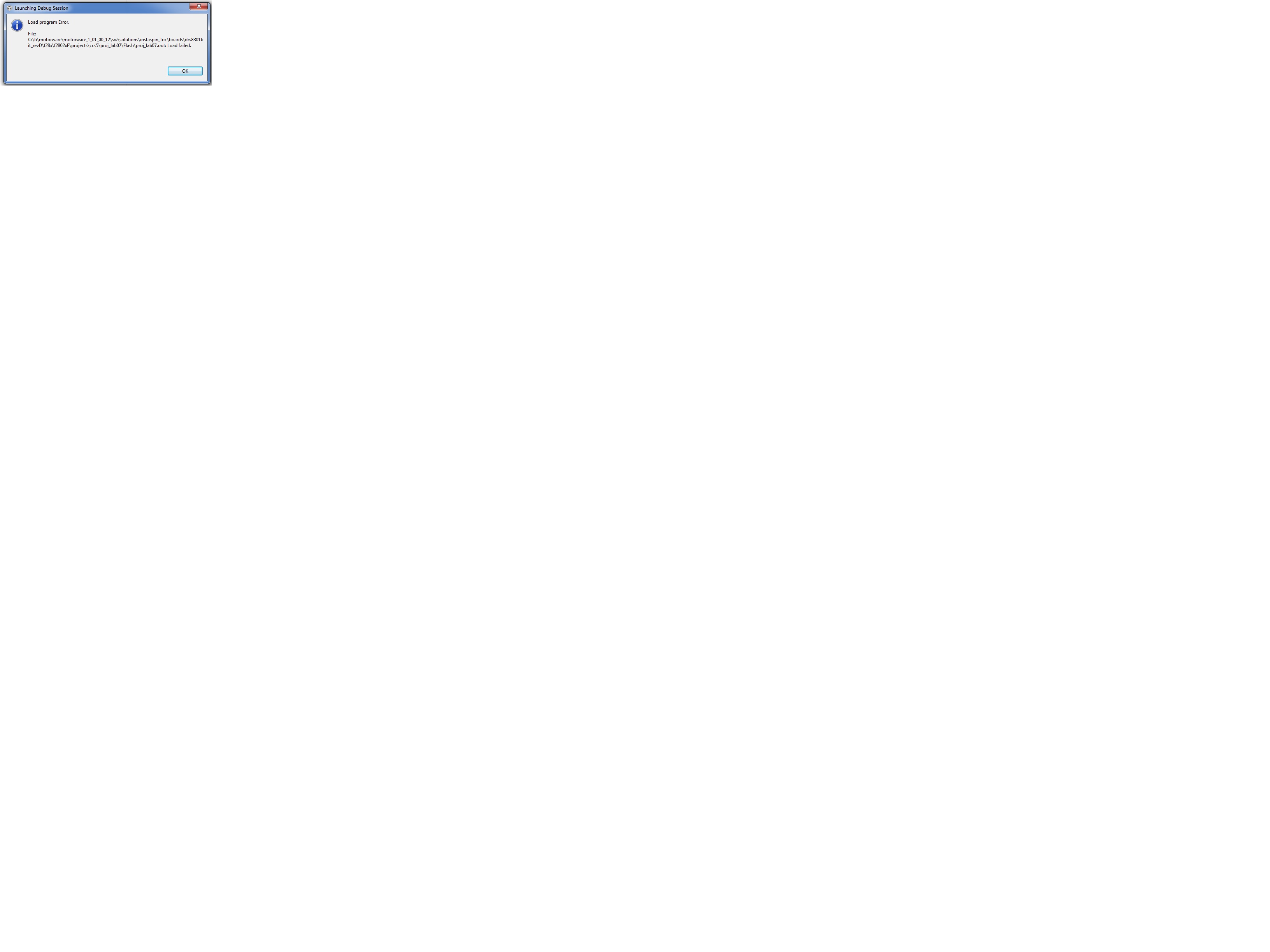

  • Well that didn't go well. I erased the chip, but I get this error upon download (programming).
    Got any suggestions?
    David
  • David,
    I would recommend that you power cycle the board and unplug and reconnect the USB cable.  Other thing to check is the switch used to automatically boot from flash needs to be returned to the default position to connect the USB debugger.
  • Adam,
    Ok, I did all the above, but I didn't change any switches in the first place. All I did is run lab6b.
    However, I did find the problem. The configured device (TMS320F28035), does not match the detected device (TMS320F28069) I double checked the file and I suppose I loaded the wrong one. The motor and I went over lab 7 and I saw where Rs changed. Question: should I have updated my user.h file here?
