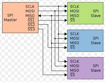

    No problem, here's its much simpler: you can directly connect the SPISOMI, SPISIMO, SPICLK and SPISTEA lines to accordingly. For eg.
    Refer spi_loopback or spi_loopback_interrupts examples for quick implementations as times running! They can be found here:

    This is much simpler, no need of any hardware. You can connect your two boards in this fashion: (just an example)
    Also, refer the SPI based examples spi_loopback & spi_loopback_interrupts that can be found here:

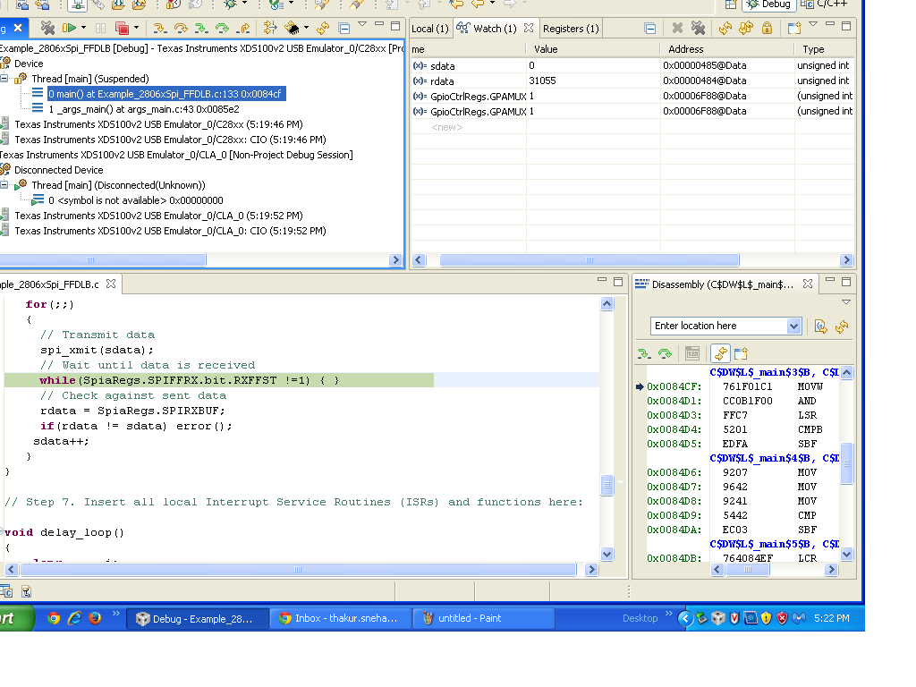

  • Hi
    After checking the signals on DSO for master i am getting output for clock only and negative voltage for MOSI and positive for MISO..
    when i check out the watch varibales
    rdata= identifier not found
    sdata=once it will be 0 and some other time it would be identifier not found..
    Kindly help.

    I am trying to that SPI interface for two f28069 control sticks..I changed the SPICCR to loopback disabled and SPICTL 1/0 for master and slave dsp's.
    But I am not getting anything when i check the watch variable for sdata it is zero at times and at times identifier is not found..while rdata has some value...
    So,am not sure whether this is true or not?
    when is check the spi_loopback example on DSO and make the changes in it for loopback disabled mode,it does nt give the required waveforms..Actaully changing any of the bits of SPICCR results in this..
    Kindly reply ,I am stuck here for last two days.

  • Hi gautam
    the example you gave me is for 3-wire master transmit mode. So even if i write this to one and 3-wire slave recieve into other dsp, rdata is not equal to sdata, nor the data of two DSPs match.
    In 3-wire mode, the receive and transmit paths within the SPI are connected, any data
    transmitted by the SPI module is also received by itself and i want to communicate between two DSPs using 4-wire mode.
    The problem I am facing is the time i disable the loopback in SPICCR the identifiers sdata and rdata are not recognised...i have earlier sent you the screenshots..
    please help me.
