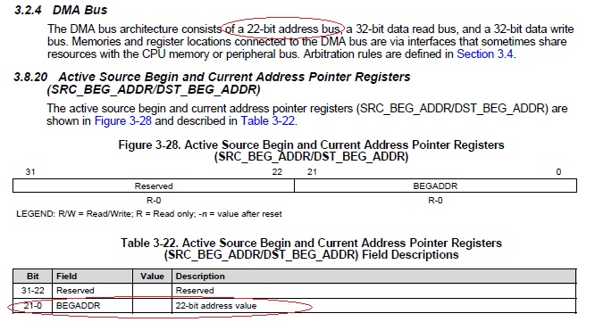

Please let me know about DMA address bus.
I found a description of the following. (Datasheet : SPRS880A)
Therefore, I think DMA is able to access the EMIF1_CS0.
But, DMA address bus is 22-bit(0x3FFFFF).
SDRAM address is 0x80000000. DMA(0x3FFFFF) is not accessible in SDRAM.
As follows.(TRM : SPRUHM8A)
Now, I have connected to SDRAM to EMIF_CS0.
How to access the SDRAM(0x80000000) using the DMA ?
