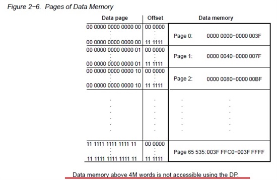

I have a question of  "F28377D EMIF_CS0".
I tried to access to SDRAM(EMIF1 CS0  0x80000000) by C pointer.
Then I was unable to access.
I think this is a limitation of the DP(Data page pointer). As follows.
Do you know "C28x compiler setting" for do not use DP.
Or please tell me how to program to access to SDRAM by C.
