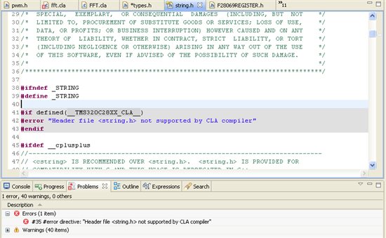

  • Dear All/Chris,
    Updating on my last query, I was checking "shiftting of debug point" by toggling EPWM7 force fully from clatask1.
    And  found that when I includes "pwm.h" file in CLA, it gives error "Header file <string.h> not supported by CLA compiler".
    And "pwm.h" has "types.h" included and further "types.h" has "string.h".
    So my main concern is, all the peripheral files(in new object style programming) has "types.h" included, so how can we use peripherals in CLA ?

  • Abbas,
    The CLA C compiler has certain restrictions on the code it compile.  This is because the CLA lacks some of the normal hardware found on a cpu to support things like branching and context save/restores.  Using the motorware drivers on the CLA is untested and not recommended.
    Chris' advice is correct.  Try looking at this:
    C:\ti\controlSUITE\device_support\f2806x\v136\F2806x_examples_cla_ccsv5
    There are several examples in this directory which show how to use the CLA.  If you copy the Compiler include paths and linker file search path from these examples and add them to your motorware project, you ought to be able to include DSP28x_Project.h and use the controlSUITE header files to access the hardware registers from the CLA.
    I know this isn't an idea solution, and we are aware of this.  We are actively working on unifying the software experience between MotorWare and controlSUITE.

  • Abbas,
    The driver/object oriented programming structure and the old type header files are no different.  They are simply abstractions of the hardware registers.  I guarantee that there are no issues mixing the two styles of register access.
    Where you may have issues is if both the CPU and CLA are trying to access the same register.  There are arbitration mechanisms built in to the chip to help with this, but it's up to your application to properly partition the device's hardware between the CPU and CLA.
