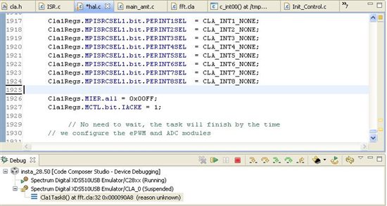

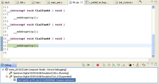

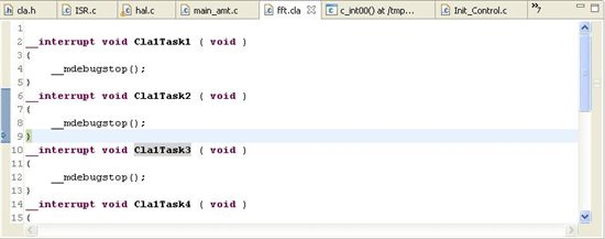

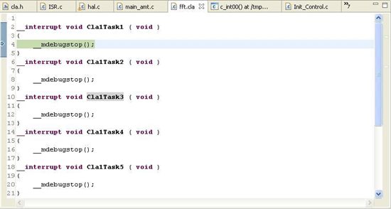

Hello Chris,
Thanks for solution, CLA starts working as per controlSUITE example.
I configure CLA to force start task1, and it runs properly.
But some problem arises, at the startup it comes to task1 where i put debug point. But when  try to run more than 4 times debug point shifts to next tasks. Screen shots added below.
Thanks & Regards
Abbas
