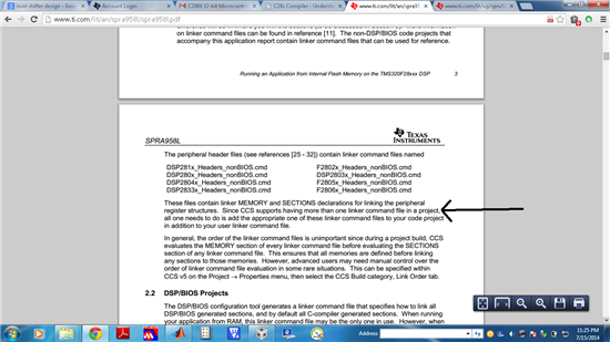

  • Hai,
    kindly see the pic,
    NB: I have experience in TI's TMS320C6678 octacore DSPs for about 2 years.
    searching with my name in the forum reveals it. I am new to c2000 series
    There I make use of XDC script and RTSC platform generation tools to specify the sections.
    I would be happy at the least if I can tell the linker command file to specify the three locations which I mentioned in the first slide
    (load start run start load end variable for ram functions)
