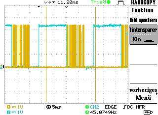

Hello, as this topic suggests, I am trying to run a motor control for BLDC Motors.
The switching pattern ís working, but I'd like to connect either high or low side to a GPIO, while the other is on EPwm.
So far so good, the motor turns.
I will Show you my code-snippet first and explain the problems later. Maybe you have suggestions.
First the Position is checked in an Epwm-ISR....
hallpos=GpioDataRegs.GPADAT.bit.GPIO16*4+GpioDataRegs.GPADAT.bit.GPIO18*2+GpioDataRegs.GPADAT.bit.GPIO20;

Vout is the pulse width on the high side as you will see next:
void UHon(int16 PWM)
EPwm1Regs.CMPB=0;
GpioDataRegs.GPADAT.bit.GPIO17=0;
EPwm1Regs.CMPA.half.CMPA=PWM;
void ULon(void)
EPwm1Regs.CMPA.half.CMPA=0;
EPwm1Regs.CMPB=3750;
GpioDataRegs.GPADAT.bit.GPIO17=1;
and so on. I will only Show you Phase U high an d low, because that is where I don't understand the behaviour. I expect both Outputs, GPIO01 AND GPIO17 to do the same, which would look somehow like this:
This is the correct behaviour, and it only appears that way when I use the epwm for the low side.

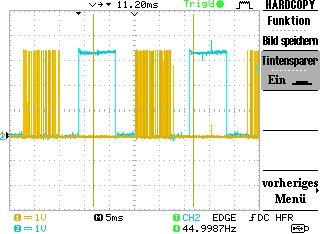

When I use normal GPIO, this happens:
And it only happens on one phase, I cannot predict (it just switched to V). It does not even matter, what IO I am using. What am I doing wrong?
