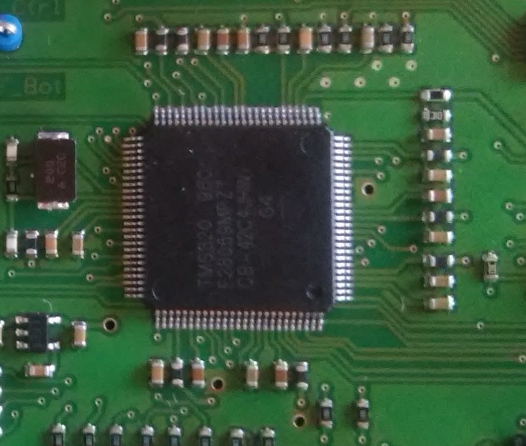

  • Can you take a picture of the part number on top of these devices please.

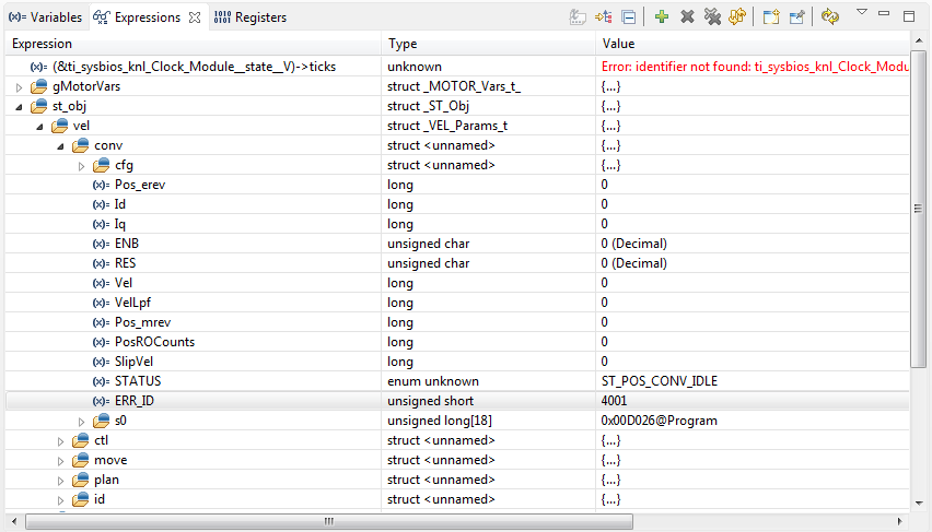

  • Hi Chris,
    what Oliver means is the error code 4001 is a spinTAC error code. You can see it when the software is running and in the debugger you have a look at the "st_obj", that has several members for spinTAC velocity and spinTAC position convert and much more. Every entry has a field ERR_ID. And in our case the two modules mentioned has the ERR_ID set to 4001.
    And as far as I know 4001 means: spinTAC license error, use the right CPU
    But we are using the right CPU. We use TMS320F28069MPZT. We have several older CPU's of the same type in use, that works quite well.
    Sebastian

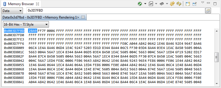

  • Oliver,
    Can you take a look at the OTP bits in the memory on your devices.  I've included the procedure below.  First you need to connect to a device through the debug interface.
    1.       Open memory browser:
    CCS Debug - proj_lab02proj_lab02.c - Code Composer Studio_2012-10-05_08-31-04.png
    2.       View memory area 0x3D7FBD
    CCS Debug - proj_lab02proj_lab02.c - Code Composer Studio_2012-10-05_08-31-54.png
    3.       Disable memory maps so you can actually see these bits. This is done by the following command in the Scripting Console: mmEnable false
    CCS Debug - proj_lab02proj_lab02.c - Code Composer Studio_2012-10-05_08-33-25.png
    4.       Now he can see those bits. If it’s an M device, you should see the following:
    CCS Debug - proj_lab02proj_lab02.c - Code Composer Studio_2012-10-05_08-35-35.png
    Please post a screenshot of what you find.
  • Oliver,
    We want to make sure whether you have the right factory settings for these parts. Can you please provide the contents of the following TI OTP locations?
    • 0x3D7FBD
    • 0x3D7FBE
    • 0x3D7FBF
    • 0x3D7E80
    Manoj

  • Sebastian,
    Sorry about that I've included the directions below:
    3.       Disable memory maps so he can actually see these bits. This is done by the following command in the Scripting Console: mmEnable false
    4.       Now he can see those bits. If it’s an M device, he should see the following:
  • Hi all,
    I did what you recommended.
    Here you can see the error code 4001.
    And here is the result in the memory browser:
    As you can see it is not what it should be. But it is a M-Type processor:
    So what do you think?
    Sebastian
  • This certainly looks like an issue.  Let us do some more research based on the lot codes.

    Has there been any confirmation that this is a bad batch of silicon? I have a number of boards built using chips with identical markings, and I'm seeing the same issues with error 4001. Do you have any more information?
    Steve
  • Steve,
    Yes, there was a batch of 69MPZT devices that were incorrectly programmed as 69FPZT, making SpinTAC non-functional.  These devices do have all InstaSPIN-FOC functionality.
    We are in process of communicating this event to our distributors, who pass it on to you the customer.
    We will be offering replacement or refund for all affected shipments.
    Please contact your distributor and you can reference my name, they will be able to loop me in as necessary.
    We do have units in process to be able to replace your devices very quickly.
