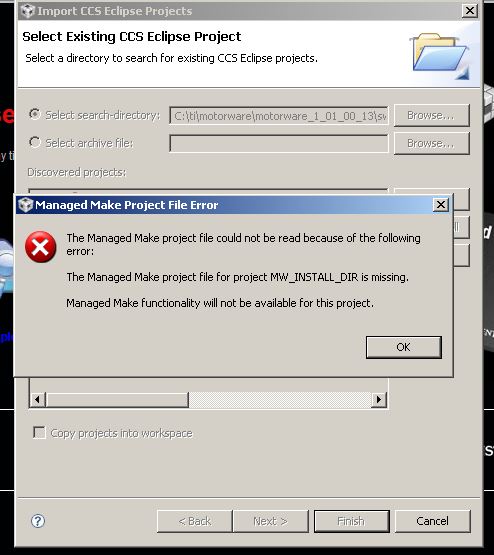

Hello ,
When I try import the first example , I have always an error .
Can someone help , please?

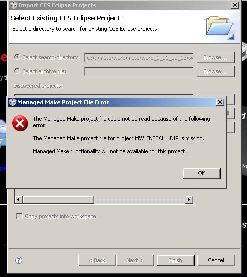

Hello ,

Hello ,
I have installed the CS S that came with the kit , I think that is the version 4 . I did the upgrade to the version 6 and now is fine .
Many thanks .
Which kit do you have? These should be shipping with CCSv5.4+ so I want to get this fixed wth our manufacturer if there is an issue.
glad it's working now.
My kit is this :
http://www.ti.com/tool/tmdsdock28069
I I bought it in about 1 weeks on Digikey
OK, yes that is an old kit when we still provided a DVD. Now we just point to the free download.
Did you buy a new controlCARD? The one included in that kit doesn't work with the MotorWare / InstaSPIN projects. For that you need TMDSCNCD28069MISO, TMDSNCD28054MISO, TMDSCNCD28027F, or LAUNCHXL-F28027F.
Yes , I bought a new control card with the dock . I need buy a new one .
