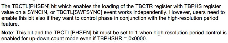

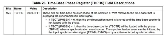

  • hi Gautam,we find the mistake。
    epwm3 does not run as we think。
    we set EPwm3Regs.TBCTL.bit.PHSEN = 0 before and now we change as:EPwm3Regs.TBCTL.bit.PHSEN = 1.
    Then we get the result :10us。
    thank you for your reply。we still want to know how this register affect the result。
    That's Great!
    That's really very strange behavior. Here's the significance of PHSEN bit:
    Gautam
