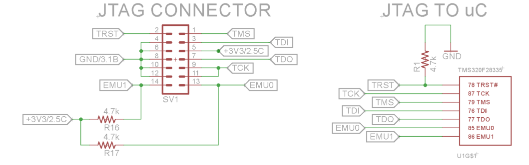

Yup, this means that your emulator is all fine! You'll have to check the connections between JTAG and controller on your custom board. Just verify with the schematics of your development board. There might be some minute issue that might've got ignored.
Gautam

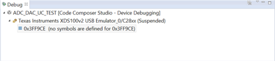

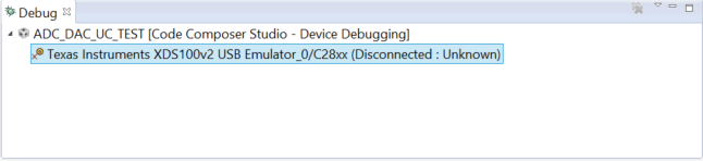

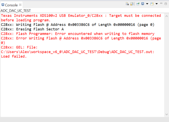

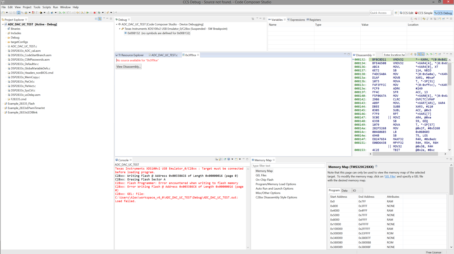

Just one thing, can you attach the screenshot of the exact error window?
Gautam
Sure, and I am also going to list step by step what I am doing.
1) Connect JTAG and power on custom board.
2) Open Code Composer Studio 6.0.0
3) Click on project I want to run in Project Explorer Window to set to "Active-Debug"
4) Right-Click on project and click "Build Project"
"C:/ti/controlSUITE/device_support/f2833x/v133/DSP2833x_headers/cmd/DSP2833x_Headers_nonBIOS.cmd" "../F28335.cmd" -l"libc.a"
<Linking>
'Finished building target: ADC_DAC_UC_TEST.out'
5) Click "Run Configurations" from Run Menu
6) Ensure correct project is selected and click "Debug"
7) Right Click on Texas Intruments XDS100v2 USB Emulator and click "Connect Target"
8) In Run Menu select Load->"Load Program" and load ADC_DAC_UC_TEST.out and press "OK"
At this point it begins erasing sectors but nothing is ever erased
then I get the following error:
Here is a screenshot of the Console Window
And this is a screenshot of the CCS window:
-Alex

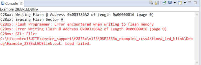

Alex,
Could you try loading one of the RAM-based F28335 example projects from controlSUITE?
Perhaps something like timed_led_blink? (and then perhaps flash_f28335 next if that works) Ideally you just need to try to load the program since your issue seems to be with the loading process.
Thank you,
Brett
Hi Brett,
Yes I have tried timed_led_blink and it does not work on my board. I get the same error when trying to erase flash. The project that I am trying to load is actually the Example_2833xEPwmTimerInt sample project, I only changed the name.
-Alex
Ssince the last post I have redesigned the board to match very closely what is provided in the hardware design guidelines and spectrum digital schematics for the ezdsp f28335. I have the same setup and am using the LED Blink sample project from TI, but I still encounter the same error.
What else could be the problem? I am baffled...
