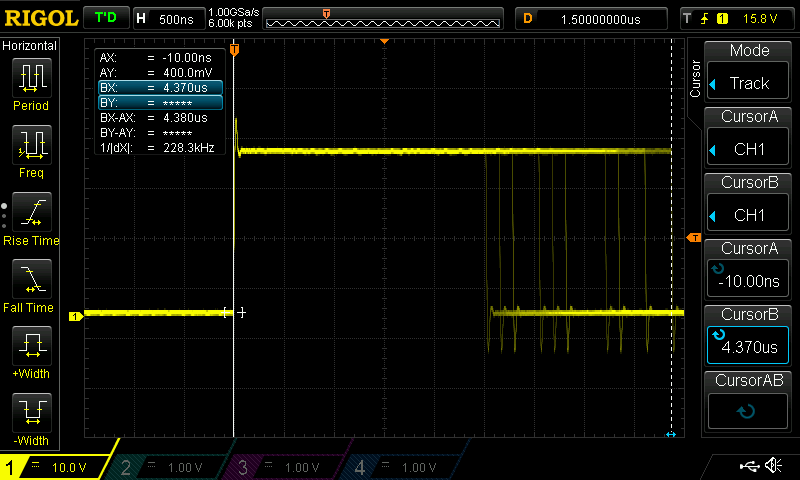

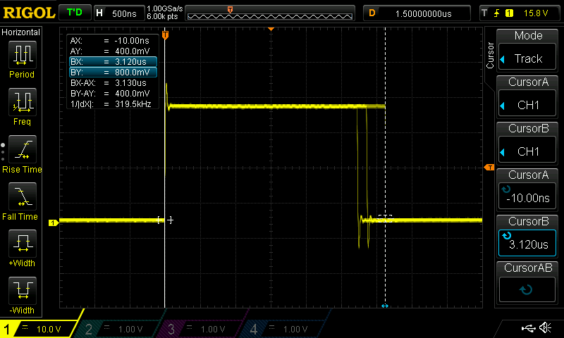

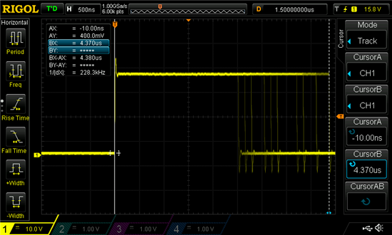

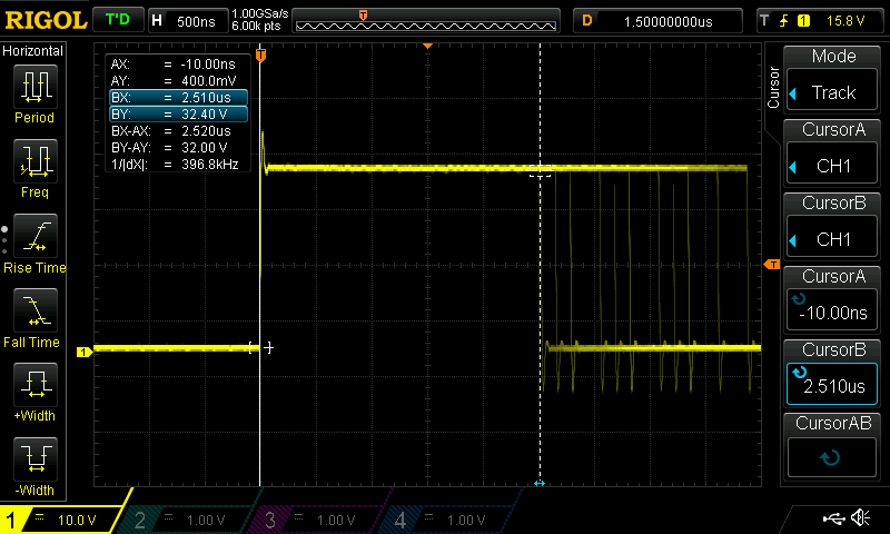

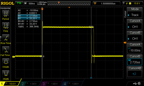

So I then basically just commented out the API command and then the direct registry command and recorded the traces on the scope.  I thought I would get a cleaner trace but there seems to be some pulse width fluctuation on the oscilloscope traces, which at this time I am not sure why?
I have tried the GPIO setup with and without the internal pull-ups, and also a combination of nothing connected to the GPIO19, and a 3k3 resistor to ground.  All the combinations of which produce the same result, so is this drift in timing expected or is my set-up in error?
Direct Registry Oscilloscope Traces - Lowest pulse width first and highest pulse width second
API Oscilloscope Traces - Lowest pulse width first and highest pulse width second

  • Hi Ant,
    My understanding:
    The setLow function takes multiple instructions (some read-modify-write or bit packing to GPIO registers and function call overhead). One of those cycles is the actual write to the HW registers which causes the GPIO to go low.  There are also some overhead instructions in the looping itself.
    When the interrupt returns, it could be at any of those instructions.  If it is the one right before the HW write, the GPIO will go low right away.  If it is the one right afterwards, it will have to return from the function, check the loop conditions and branch to loop start, re-enter the function, do the bit-packing, and then do the write.  You can also have everything in-between, which is why you get the spread of low going times.
  • Hi Devin,
    Thanks and makes sense, also explains why you see a lesser effect in the direct registry command.
    I guess for timing I can use the mean value as a good approximation.
    Cheers,
    Ant
