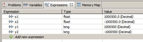

  • Charles,
    It looks like you're trying to round at the same time you're converting to integer?  Otherwise, why are you adding in the 0.5?  I tested this using c2000 cgtools v6.2.7:
    float32 x1=1000500.0;
    float32 x2=-1000500.0;
    int32 y1, y2;
    y1 = (x1 >= 0)? (long)(x1+0.5) : (long)(x1-0.5);
    y2 = (x2 >= 0)? (long)(x2+0.5) : (long)(x2-0.5);
    I get y1=1000500, and y2=-1000500.
    I ran this on F28069 device, with floating point enabled (HW floating point), and floating point disabled (uses software library).  I get the same results in both cases.
    David

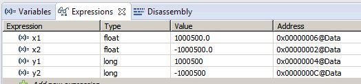

  • Have you tried
    y1 = (long)x1;
    or
    y2 = (long)x2;
    y1 would be 100499 and y2 would be -100499 and not the desired result.
  • charles saperstein said:
    Have you tried
    y1 = (long)x1;
    or
    y2 = (long)x2;
    Yes, I did actually try that first.  It gives me the same results as with rounding.
    int32 y1, y2;
    y1 = (long)(x1);
    y2 = (long)(x2);
