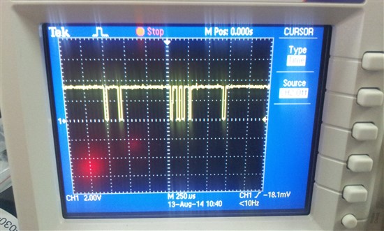

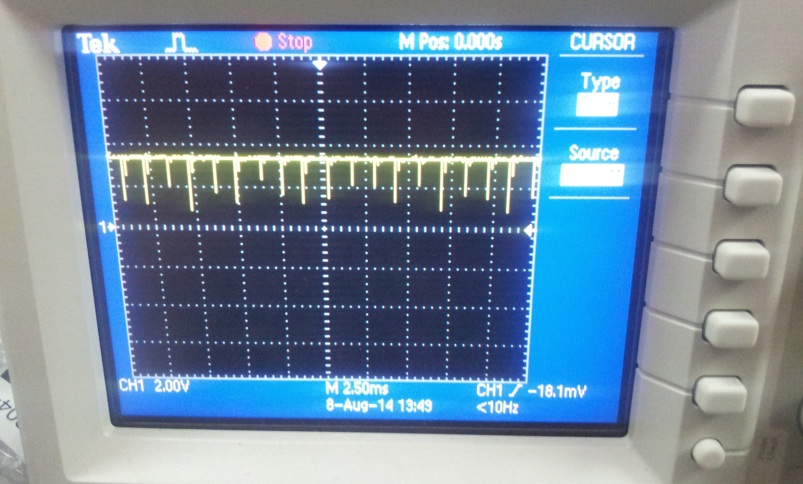

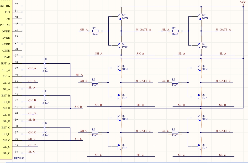

There are sixty MOSFETs on my inverter.The OCTW PIN turn low level and the led gave out light on my board when power on.I guess external FET is overload.
So I changed the number of MOSFETs from sixty to six.Everything is back to normal when power on.
I guess output drive capability of DRV8301 is not strong enough for sixty MOSFETs.So I want to know whether TI has another high-drive capability chip to replace DRV8301 or has other solutions for multi-parallel MOSFETs ?
BTW : Are they legitimate about the capacitance capacity and the gate resistor for InstaSPIN technology?
