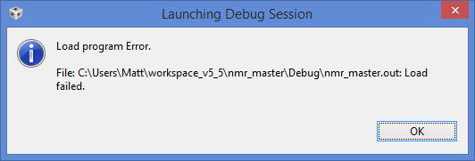

    I've just managed to brick another micro. Here is exactly what happens:
    1. I build the Debug version on my project for both the M3 and C28 core. This is designed to run from RAM.
    2. I hit the debug button in CCS. The debug config should load both the M3 and C28 code.
    3. It starts erasing the flash for the M3 (which is weird, given the project runs from RAM).
    4. It fails, and I get the following dialog pop up:
    5. I get the following in the console:
      Cortex_M3_0: GEL Output: Memory Map Initialization Complete
      Cortex_M3_0: GEL Output: Watchdog Timers Enabled
      Cortex_M3_0: GEL Output: UARTs Enabled
      Cortex_M3_0: Can't Run Target CPU: (Error -2134 @ 0x0) Unable to control device execution state. Reset the device, and retry the operation. If error persists, confirm configuration, power-cycle the board, and/or try more reliable JTAG settings (e.g. lower TCLK). (Emulation package 5.1.232.0)
      Cortex_M3_0: Error: (Error -1170 @ 0x0) Unable to access the DAP. Reset the device, and retry the operation. If error persists, confirm configuration, power-cycle the board, and/or try more reliable JTAG settings (e.g. lower TCLK). (Emulation package 5.1.232.0)
      Cortex_M3_0: Unable to determine target status after 20 attempts
      Cortex_M3_0: Failed to remove the debug state from the target before disconnecting.  There may still be breakpoint op-codes embedded in program memory.  It is recommended that you reset the emulator before you connect and reload your program before you continue debugging
      Cortex_M3_0: Error during Flash verification (Flash algorithm returned error condition). Operation cancelled.
      Cortex_M3_0: Flash verification returned error condition. Operation cancelled.
      Cortex_M3_0: GEL: File: C:\Users\Matt\workspace_v5_5\nmr_master\Debug\nmr_master.out: Load failed.
    I'm getting a bit frustrated here. Nobody at TI seems to even be acknowledging the problem, let alone attempting to help fix it. CCS seems to have bricked 3 of our boards. Not happy.

  • Bump to try and get a response.
  • Matt,
    OTP is is one time programmable, so you cannot fix the broken devices.
    If you are just programming an alternate boot pin configuration in OTP (few words) why do you need to declare an OTP section of length 0x1000 in linker command file? you can just restrict the size and start address of the sectors to what you really want to be linked into OTP and don't even put the rest of the OTP address in the linker command file.
    or you can have NOLOAD attribute to the rest of the OTP sections to which you don't want anything to be linked.
    Best Regards
    Santosh
