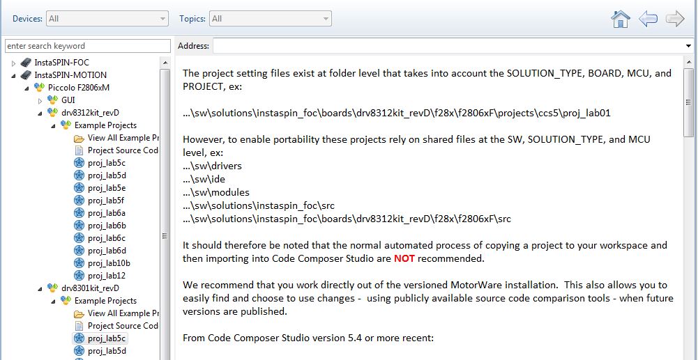

I'm trying to compile a example of the motorware package but I got the error #10099-D program will not fit into.  I have CCS6.  In CCS6 There isn't an option to select the F28069M.  Do I have to go back to CCS5?

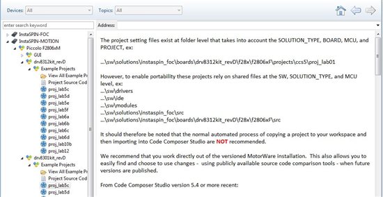

  • If I don't copy the project to my own the workspace it compiles correctly.  What I have to do to copy everything to my own workspace so I can begin playing with the code.
  • Ernst,
    I don't recommend you to copy lab project from motorware folder to your work space.
    Here is the comment in motorware.
    It should therefore be noted that the normal automated process of copying a project to your workspace and then importing into Code Composer Studio are NOT recommended.
    We recommend that you work directly out of the versioned MotorWare installation. This also allows you to easily find and choose to use changes - using publicly available source code comparison tools - when future versions are published.
