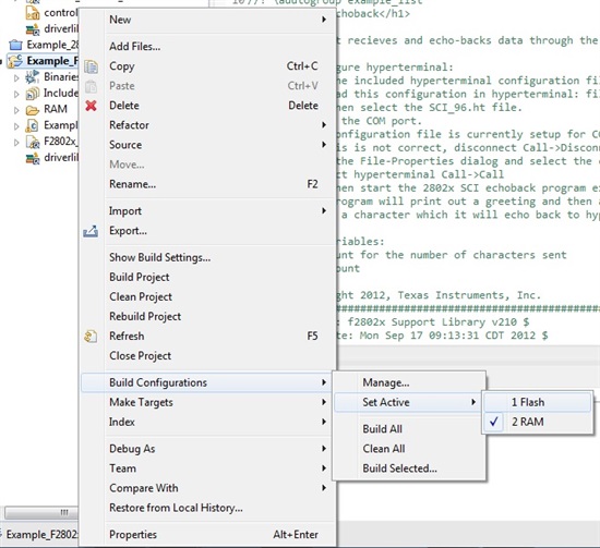

Hello. I have C2000 launchpad f28027. Using controlsuite i wrote programm that read ADCINA1 and changes duty cycle of PWM1. No errors, i clicked "debug" and it works!!!. But every time, when i reconnect board, program resets, because i write it to ROM(?). What i must change in CCS/my program/board for saving it to FLASH

  • Look at an example which the program is loaded into flash.
    The .cmd file is the file you should follow as an example.
    Something like this (this is an example from the 28069 not the 28027):
    Yup, this happens as the code is running through RAM. For standalone applications you'll have to run the code through flash. For this you've to edit the linker file ie .cmd file. For detailed info go through this pdf:
    2273.Running from Internal Flash.pdf
    For quick implementation, you can refer "flash_f280x" example project that can be found here:
    C:\ti\controlSUITE\device_support\f2802x\v220\f2802x_examples_drivers\flash_f2802xX
    Gautam
    In another topic i told about 2 versions of examples:v1.x and v2.x. Guide http://e2e.ti.com/cfs-file.ashx/__key/communityserver-discussions-components-files/171/2273.Running-from-Internal-Flash.pdf is only for v1.x examples (change .cmd file, add some functions), but v2.x project examples consyst : main.c, driverlib.lib and xxxx_nonBios.cmd and there are nothing about F28027.cmd or F28027_RAM.cmd: it connects some compiler option (may be _FLASH?)
    I understand, for v2xx projects here's the option:

  • But i dont have Flash or ROM configuration, i only have "Debug" and "Release"
  • I hope this project is from the latest version: C:\ti\controlSUITE\device_support\f2802x\v220
    If not, import any project from the above version and check. Also, above I'm able to see 2 cmd files! Why 2?
    Gautam
  • This is precisely the problem: control suite examples consists ROM and Debug configurations. When i create my own project from 0, there are only Release and Debug. And question was "what i must change in code/project/project_options" if i want program to flash:
    1. Change .cmd file:ok. In versions 1.x i can do it, in 2.x versions there are only nonBios.cmd. What project configurations i must change?
    2. add code to main()
    i tried manually add flash_cmd file
  • Try opting for the simplest way ie use the Flash based example project and paste your custom code to it.
    Also, if there's a F2802x_Headers_nonBIOS.cmd file in the project, you should have an option for RAM & Flash as shown in the above screenshot. That's exactly why I'm asking you to example from here: C:\ti\controlSUITE\device_support\f2802x\v220\f2802x_examples_drivers\flash_f2802xX
    Gautam
  • i need configurations for project, i dont want copy-paste code to other project with unclear parameters. I create default project and there is not Flash or Rom. Most importantly I could not find information about the difference between Flash and Rom  or Debug and Release configurations. All suite examples have Flash and Rom, but dont have Debug and Release :D
    Seems odd. OK, these are the only steps that everyone follows: (I prefer only v129 - as its more customizable giving you detailed control)
     So, you need to add these two statements
    MemCopy(&RamfuncsLoadStart, &RamfuncsLoadEnd, &RamfuncsRunStart);
    InitFlash(); after InitPieVectTable();
    Add DSP2802x_MemCopy.c file to the project.
          Define extern variables above main() function.
                                        extern Uint16 RamfuncsLoadStart;
                                        extern Uint16 RamfuncsLoadEnd;
                                        extern Uint16 RamfuncsRunStart;
        Replace 28027_RAM_lnk.cmd with F28027.cmd
        Compile the code.
        Configure your GPIO's to boot to flash.

    Try this:
    Go to your project 'Properties -->Processor Options' and set configuration as 'Release [Active]'.
    or from 'Build Configurations-->Set Active-->Release'.
    Gautam
