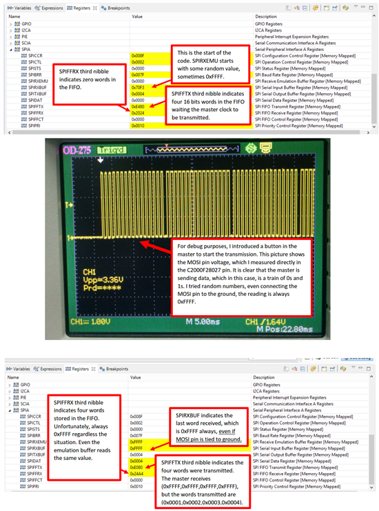

I call for help with a strange situation with SPI connection. I want to connect a slave F28027 to a master ARM processor. The master works fine, it sends four 16 bit data and I can see the slave FIFO being populated accordingly trough debugging and, trough a logic analyzer, I can ensure the master sends correct data. However, the slave F28027 processor only reads 0xFFFF in each word transmitted. Even if I disconnect the MOSI pin, it still reads 0xFFFF regardless the situation. I have checked all the connections,  the SPISTE is connected to a GPIO in the master and the slave sends dummy data while receiving. I even tried replacing the slave processor, but the same occurs.

  • Any TI employee? It is a really weird problem. I already tried loopback to see if the SPI module works and it responds perfectly. The other processor is also fine. What am I missing here??? =((
  • Hi Filipe,
    Can you please clarify this? Are you saying that the RX FIFO on the slave is being correctly populated, but you can only read 0xFF out of it in your code?
    Please post your code as well as screenshots of your logic analyzer captures, if possible.
    Sam Friedman
  • Hi Sam, thank you for your answer.
    Yes, exactly. But, as I don't have access to the FIFO registers (only the FIFO status), I can tell only it receives the correct number of words, but I don't know if they are the correct words. I will try to explain step by step in the following figure (if the image is bad to read, see the PDF attached. 3010.Doc1.pdf):

    4. The Slave (F28027 processor) receives only 0xFFFF, and the Master reads also 0xFFFF.
    I think it is a SPI module error, but I can't affirm that. I have tried three different processors (F28027 Launchpad, all new in box), with the same result.

    I did as you asked: Disabled the pullup resistors in all four pins of SPI, namely GPIOs 16, 17, 18 and 19, but no success so far.

    I contacted the user who posted the other post I cited before. He told me that the datasheet (I don't know which, I asked him and I am waiting the answer) says it is a standard read (0xFFFF) when something is not multiplexed correctly. Do you know something about that? Thanks.

    First, in your init_SPI_GPIO() function, you mux the clock and STE signals, but not MOSI or MISO.
    Second, you set the input qualification on all IOs to be 0, which is synchronized to the system clock. For the SPI pins, set the qualification to 3, which is asynchronous. This mode is used to allow the signals to be read directly by the SPI module, without any sort of synchronization delay or glitches from the GPIO module.
    Let me know if these changes solve your issues. If not, I'll move ahead with my own tests.
    Sam
  • Dear Sam,
    Thank you very much. Your guidance helped me to solve the problem.
    Indeed, the MISO and MOSI pins were not correctly adjusted in the MUX settings (what makes me look silly). However, it did not solve the problem immediately, I had to set opposite clock settings in the master and in the slave, one trailing and the other rising, and, I don't know why, that finally corrected the problem.
