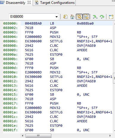

I am developing a bootloader on the F28377D device which will read in a binary file from a USB. I am able to read in the data from the USB and write it to Flash, but when I try to branch to the start of the application code I get an error that says that no source is available for the at  0x080000, which is the begin address specified in my application code linker file.
Every section of my application code is defined to be within Flash sector A.
Flash A in my bootloader project has a start address of 0x080000
The bootloader is put into Flash sectors K to N.
The bootloader is using the interrupts for the USB to read out the data. Before branching to the application code the interrupts are disabled.
However once the program branches, the application code doesnt run.
Any help on resolving this issue would be appreciated.
Anish

  • Hi Adam,
    I loaded in the symbols . When I step through the symbols source file , at InitSysPll(XTAL_OSC,IMULT_20,FMULT_1,PLLCLK_BY_2);    the code steps into the middle of InitPeripheralClocks() function.
    I am not programming ECC along with the flash data as I am using :
    oReturnCheck = Fapi_issueProgrammingCommand((uint32 *)u32Index,(uint16)dataStorageBuffer+i,
    wordsRemaining,
    0,
    0,
    Fapi_DataOnly);
    I am able to see the correct Flash code in the disassembler , when compared to the blinky code memory . I have attached it below.
    Also , when branching my code to Flash E , I use
     asm (" LB 0x088000");
    Is this corect?
  • Anish,
    Programming ECC is mandatory if you want to read or execute the flash data.
    Your use of LB is correct. If you'd rather use pure C, you can create a function pointer to the address:
    void (*funcPtr)(void) = (void (*)(void))loadAddr;    //Assign the address to the pointer
    (*funcPtr)();    //Call the "function" at address 0x088000
    This will get compiled into an LCR instruction, which will cost you 32 bits of stack space.
