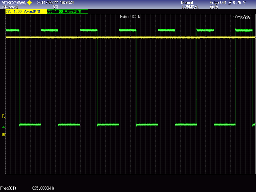

I used demo 3A to check that my motor is running and my encoder is working correctly (scope)
Then I run demo 12A.
What I see is that the motor is toggling only one line from the encoder. motor is vibrating.
Then I got the errors 2003 or 2004. I set the speed as low at 100 RPM and the gMotorVars.SpinTAC.VelIdTorqueRampTime_sec at 1. No luck
I also switched the encoder wires but that didn't work.
So I'm out of options but did I mess-up my user.h
