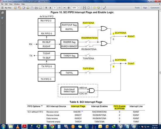

I'm working on Tms320f28035. I want to enable interrupts for the Scia tx and rx. This is the configuration that I'm using to set Rx and Tx. The Rx interrupt is working fine, but the tx interrupt is not working.

scia_fifo_init(); // Initialize the SCI FIFO
scia_echoback_init(); // Initalize SCI for echoback
SciaRegs.SCITXBUF = 0x61;

SciaRegs.SCIFFTX.all = 0xE023;//
SciaRegs.SCIFFRX.all = 0x2021;// 0x2021
SciaRegs.SCIFFCT.all = 0x0000;
SciaRegs.SCIPRI.all = 0x0008; // for debug
I'm enabling the TXFIFO interrupt in the Rx ISR. (SciaRegs.SCIFFTX.bit.TXFFIENA = 1;)
