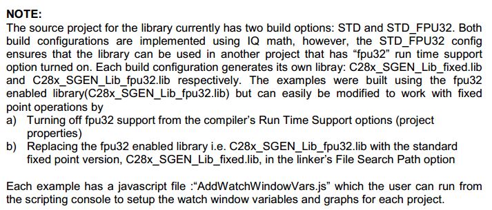

  • Another way that I can develop is trying to use the signal generator library. I´ve looked over the controlsuite but the code examples are for another device, is it possible to run that code in the launchpad?
    Yes, you can implement the SGEN library for F28027 and the same is mentioned here:
    Also, don't forget to refer this doc: C:\ti\controlSUITE\libs\dsp\SGEN\v101\doc
