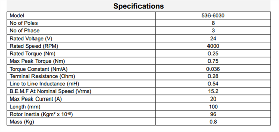

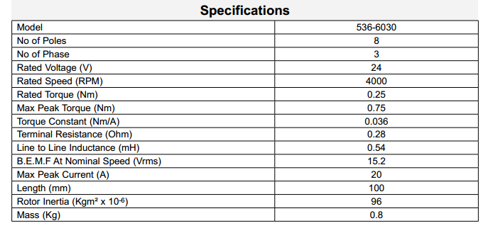

1x 42bl100 BLDC motor from RS online. Se parameters below or get Motor datasheet here

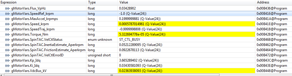

The motor behavior is OK for positive speeds, however when I set negative speeds the motor stops rotating for lab 3 and up. I know that the motor is able to behave nicely since I can run the 2a lab to identify the motor, and then afterwards I can actually spin the motor in both directions. When I then update user.h and load the following labs (f.x. lab 5d), the motor params are correctly loaded but the motor will only spin in one direction.

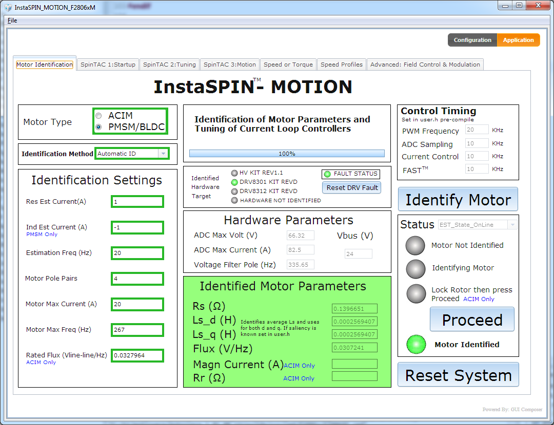

Additionally I tried the InstaSPIN_MOTION_F2806xM gui and to my surprise it also correctly identified the motor and it would also spin in both directions.
This is what I see in CCS debug view when instumenting a negative speed

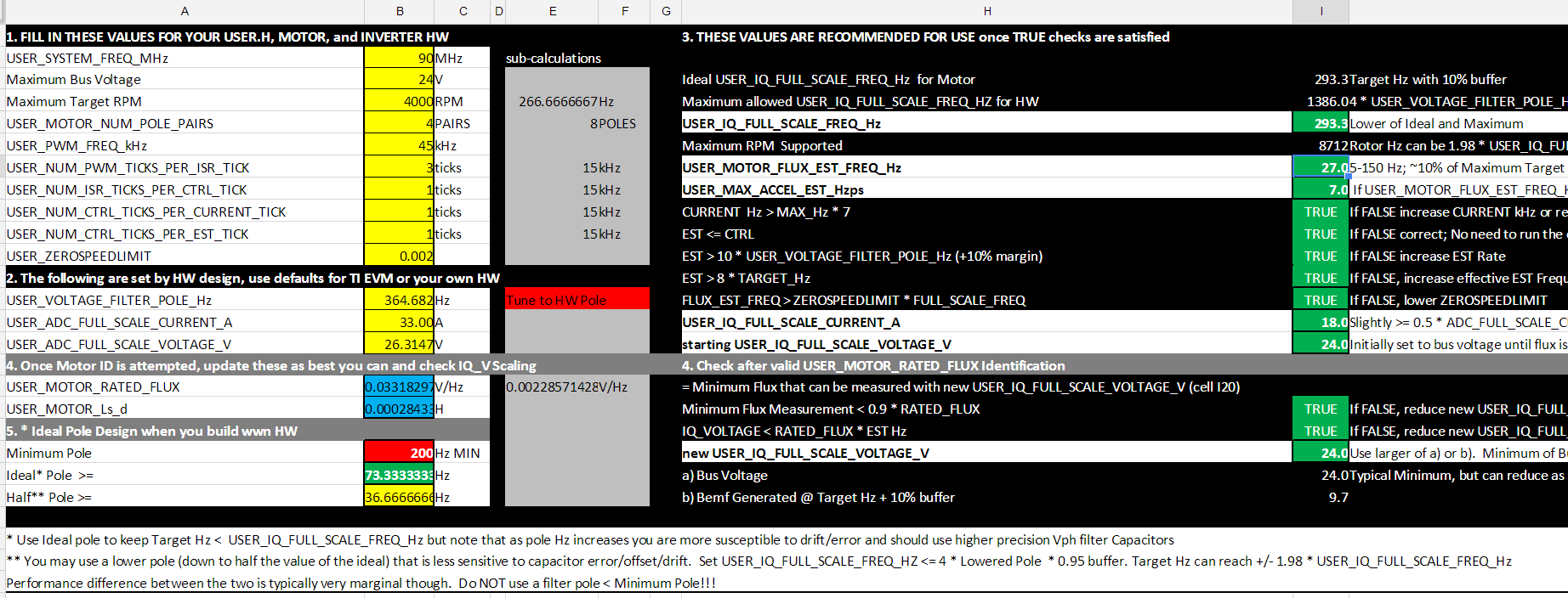

This is what I entered in the excel sheet:
