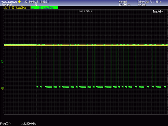

     I see the welcome text in the terminal program. But when i try to echo back. No result, high to half-level signal on scope. It seems to be that GPIO29 is active high and an output.
     I see the welcome text so RX and TX are not crossed.  I checked with the scope that my TX (pc) signal is correct.

  • The DSP TX line works fine. It is the DSP RX signal that isn't working.
    if I send a 'a' from my pc I see it the scope picture above.  If i disconnect the wire from the DSP the signal is correct.(0  - 3.3V signal)

  • Look at the scope picture. This signal isn't correct.
    The signal doesn't make it to ground. Why? the FTDI usb-> serial converter isn't capable to sink the signal. Because it is broken(Don't think so)  or the control  source more than the FTDI can sink. But why is the controller sourcing a input signal. When I disconnect the pin. The (!!RX!!) pin is still high (without pull-up).
     I think that is strange and can't find why. Also tried it on different demo boards and they have the same problem.
    To proof: This are both serial signal. Green is controller TX(at start-up). Showing the welcome text.
    Yellow is the RX signal: floating(Not connected to PC) with 3.3k Pull-down resistor!!. So I think there is something wrong with the demo.

  • Very wierd! The TTL signals should not cross the 0 towards negative side. Are you sure these are the TTL signals towards & from the controller?
  • There are internal PUs on the IOs, but these are very weak, ~200uA.  You could go into GPAPUD register and disable the one on GPIO28 to be sure, but this wouldn't hold the signal high against it's own driver or a 3.3kOhm PD as you mentioned.  I just want to take that out of the equation.  Also, just to confirm J12 is removed, correct.

    I breakpointed direct after this code and the signal is still 3.3V. And that is odd because of my 3.3k resistor at the input. (checked with scope)
    I changed the module for an other one,  with the same result.
  • After a week searching what I did wrong. I changed from SCI-A to SCi-B. And redid the I/O pin test and modified the example code to work with SCIB GPIO18 and GPIO19. And this worked. directly as expected
    I have the same problem with 2 of the same boards. So I think you have to check you're F28069M silicium.
