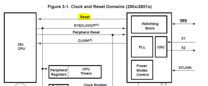

  • Hi Richard,
    The periodic switching of the XRSn pin looks similar to behavior from a watchdog reset, but I would expect that this would continue and not stop.
    The following can be found in the System Control and Interrupts Reference Guide:
    It looks like other than your SVS and the WD, another source of the reset could be your external clock.  Can you scope the clock during these XRSn toggles as well?
    Adam
