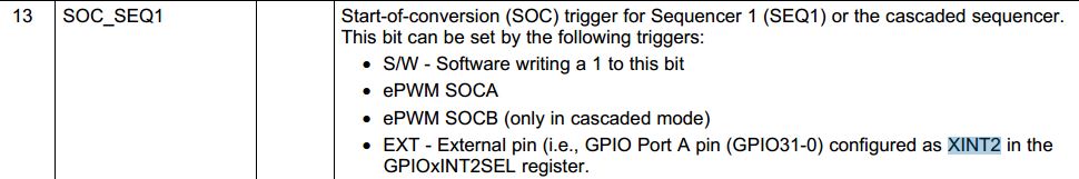

I am trying to use the external interrupt to trigger ADC conversion in F28335. I configured GPIO10 as the source for the external interrupt 2 with the configuration as in the sample code. However, the interrupt is always triggered without any input trigger signal. I tried with other GPIOs, the same situation repeats.
Is there anyone could help me figure this out?
