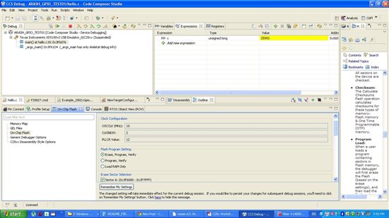

I just started working on C2000 LaunchPad, I write a simple code and build it, I run debugger and in debugger perspective I can run the application but when I go to tool->on-chip flash what I see is like the screen shot . the clock setting is disable and there is no ProgramLoad button. I cant load my code in flash can someone help me plz

    Your final motive is to load the code to flash, right? Currently the code might be running through RAM.
    For this purpose you can refer the flash sample code available here:
    C:\ti\controlSUITE\device_support\f2802x\v129\DSP2802x_examples_ccsv4\flash_f28027
    Gautam
  • Yes I'd like to run my code on flash. But the linker command file that I am using is F28027_ram_lnk.cmd. Is that because of this my code run on Ram instead of Flash? If so how to switch to Flash?

    Yes, exactly! Refer this doc for step by step instruction:
    6431.Running from Internal Flash.pdf
    Simultaneously, refer the above example in controlSuite.

  • Arash, the above document "Running from Internal Flash" is all you've to refer. If you're still unable to follow, here are the steps to convert a RAM code to flash:
    So, you need to add these two statements
    1. MemCopy(&RamfuncsLoadStart, &RamfuncsLoadEnd, &RamfuncsRunStart);
    2. InitFlash(); after InitPieVectTable();
    Add DSP2802x_MemCopy.c file to the project.
    Define extern variables above main() function.
                                        extern Uint16 RamfuncsLoadStart;
                                        extern Uint16 RamfuncsLoadEnd;
                                        extern Uint16 RamfuncsRunStart;
        Replace 28027_RAM_lnk.cmd with F28027.cmd
        Compile the code.
        Configure your GPIO's to boot to flash.
