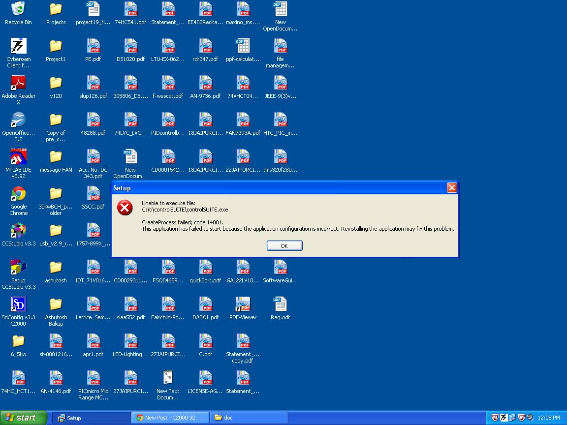

Today I download the Controlsuite and installed into my computer. But When I launch control suite It shows this error. How can I resolve it.

Hi Ashutosh,
This might be happening due to absence/lower version of Microsoft Visual C++ 2005 Redistributable pack.
This should solve your issue.
Gautam
Sir,
Now that error has gone but still it is not opeaning..
msgbox written that "this application has failed to start because the application configuration is incorrect. Reinstalling the application may fix this problem".
some thing else have to download ....??
ashutosh bhatt said:msgbox written that "this application has failed to start because the application configuration is incorrect. Reinstalling the application may fix this problem".
Has the installation file downloaded completely? Also, does the installation complete properly or does it halt with any error?
Gautam
Sir, It is solved.
I was trying to install CCS latest ver. from the net but unfortunately due to my limited data limit in company it was aborted, But after I run again control suite ; It opened successfully.
So really some of file was missing as you said and these files are provided with the CCS latest ver 6 so now it is ok.
