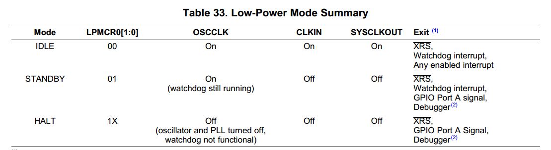

I didn't see off-hand in the data sheet if the processor has the ability to wake on input change.  For example, if a user pushes a button, the MCU wakes up to service the request. Can this MCU wake on input change?
    Here are difference ways to exit the low power modes:
