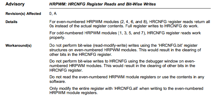

    many thanks for your support on issue (1) and (2) so far.
    Regarding issue (3) with HRPWM and AutoConv functionality I can reproduce the behaviour using hrpwm_duty_sfo example as well.
    Obviously it is not possible to enable Auto-Conversion on ePWM Channels 2,4,6,8 (see attached screenshot).
    All writes of 1 to Auto-Convert Register (CPU Writes or Debugger) Writes are not successful....
    Jeremias
  • Jeremias,
    Just to confirm the issue you are seeing here- are you only having trouble enabling AUTOCONV in EPWM8 or in all of the even modules (2/4/6/8)?  The original post said just EPWM8, but the screenshot appears to show the issue with all even EPWM modules.
    If it is the latter, then this is a known issue with the earlier revisions of silicon.  Please see the errata document for more details- the specific one is pasted below.
    This issue has already been fixed in the latest revision of silicon.
    Kris
  • Hi Kris,
    that's it. I recognized this issue only for ePWM8 first, as this is the only even ePWM Output using HRPWM in my design. Afterwards I saw this issue with all even channels....
    But many thanks for this hint, that's exactly how my hardware revision works. Therefore the workaround on my side is clear and solves the problem. Great!
    Many thanks....
