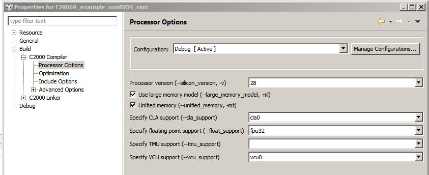

  • I'm using the F28069M and I think there is something wrong in the rom or the IQmath lib. Specially the IQ to float conversion.  That is the reason why I ask to compile the library under FPU32 and test if the motor is running.

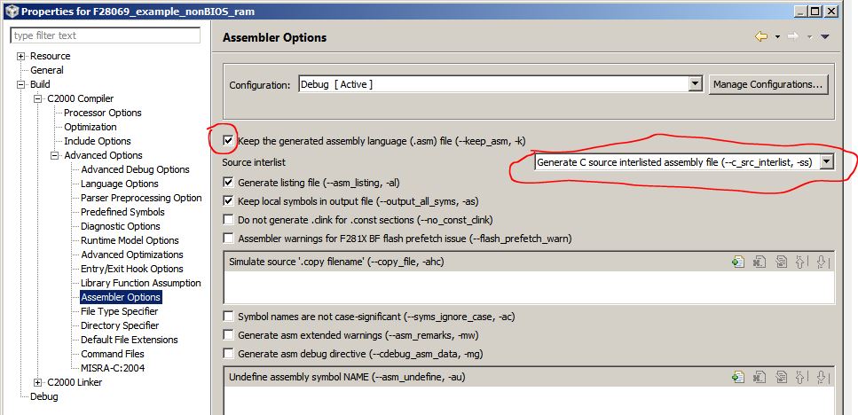

    how do I output asm code?
    edit: I think the problem is in IQ24toF compiled with FPU32  But I can't check that.
  • My project is built using fpu32 code model:
    I am running on a F28069 (regular device, not the Instaspin 'M' device).
    You can access the .asm files in the project options, Build->C2000 Compiler->Advanced Options ->Asxsembler Options.  Check the -k option, and also use -ss to interlist the C source.
    If you think there is a ROM problem (I doubt there is, but...), adjust your linker .cmd file to NOT use the IQ stuff in the ROM.  You probably have something like this in your .cmd:
